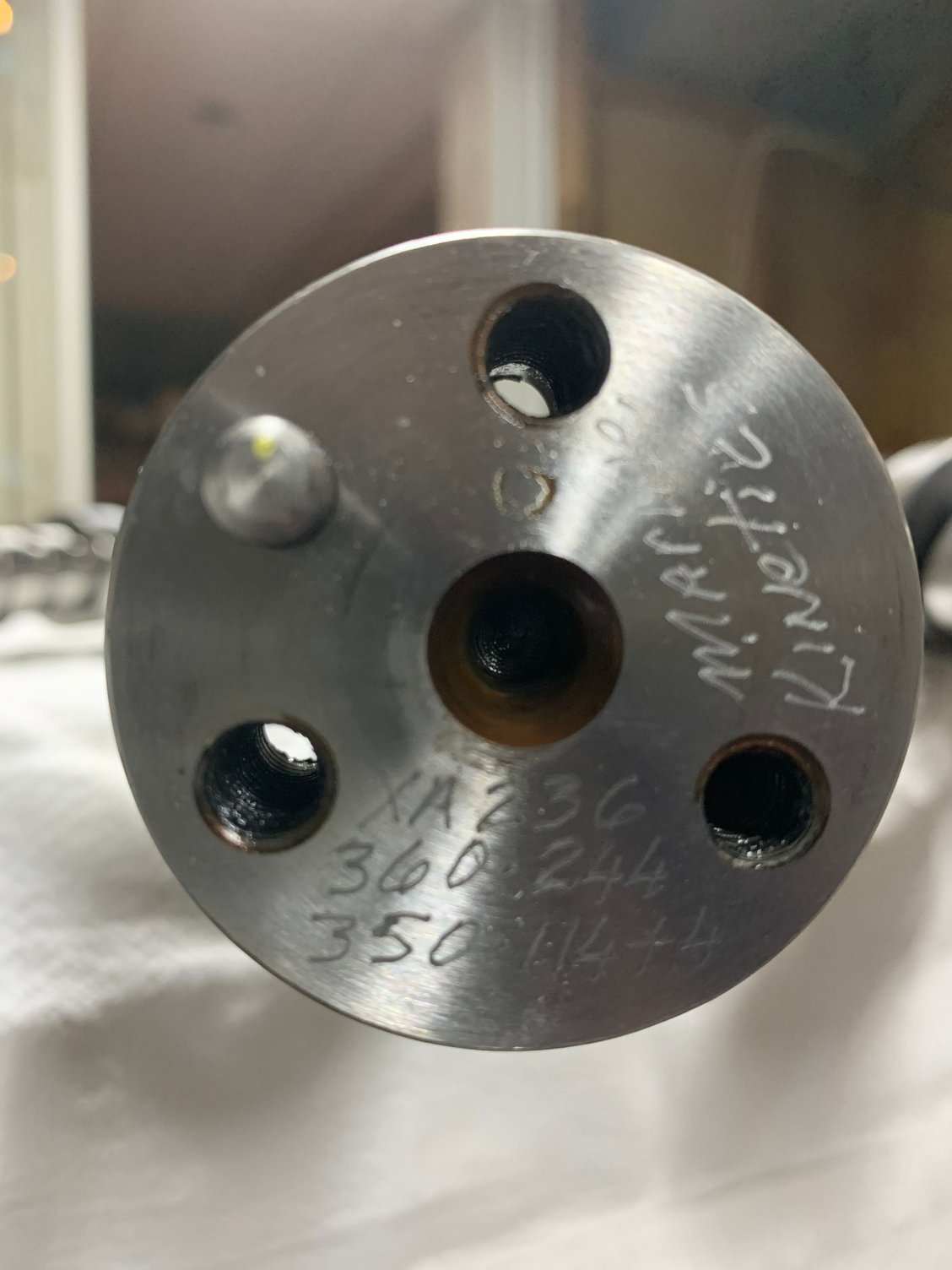

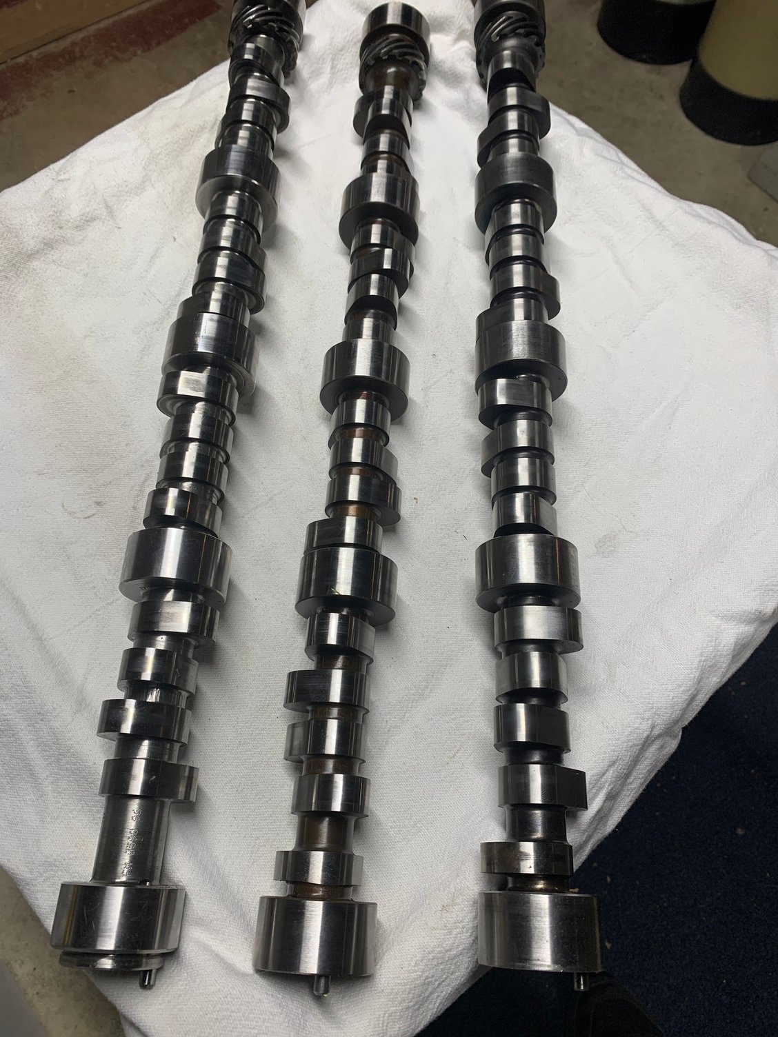

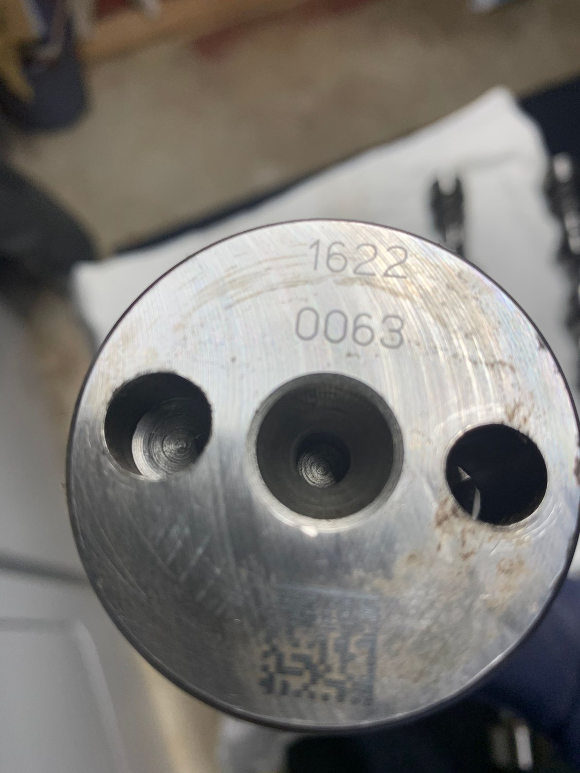

Gen 6 502 stock 211 230-510 540 $50

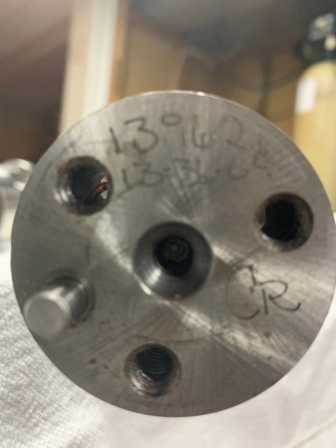

Crane Mark 4 #139621 iron dist gear 214 222-553 576 110 lobe sep. $250
Marine Kinetics/cam motion Mark 4 iron by dist gear
236 244-595 612 114 love sep. $250

You need wide lobe separation with a supercharger so the marine kinetics might be a good fit. I believe it’s very similar to Merc 525 cam. What else can you tell me about the engine. Heads, compression ratio, amount of boost and rpm range would be helpful.

I think the specs are right where you need to be. It’s marine kinetics cam (Rmbuilder) here on oso. You could message him and see what he thinks.
