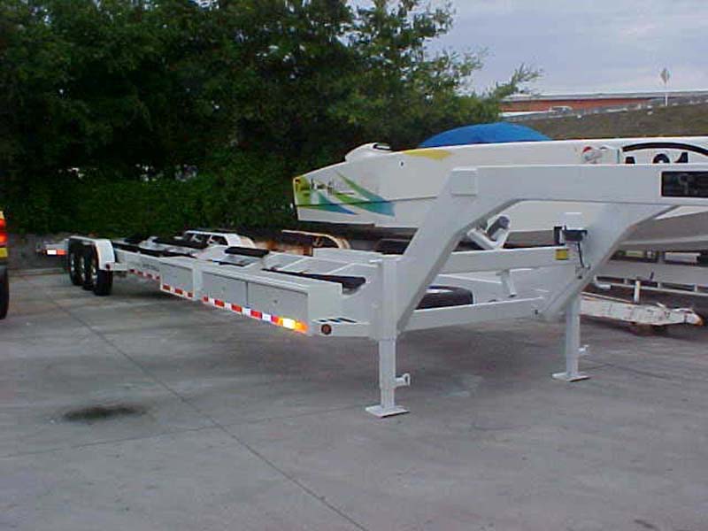

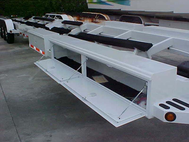

Here is our current trailer. We have two 8' boxes on each side and a 4' box on each side. Myco does a great job installing the boxes. Notice how they put step plates at the ends of the boxes so that they blend in with the trailer for a nice clean look. This also gives people a place to stand instead of them being on top of the boxes.
Like the others mentioned, we carry tools and cleaning supplies in the boxes. This trailer has water tanks and a fresh water wash down system so we use the two little boxes on each side for hoses. One of the big boxes on the left carries filters and enough of each fluid (engine oil, drive oil, steering fluid, trans fluid, etc) to refill and/or completely change all of the fluids one time. This is great for extended trips. The other large box on that side carries the cleaning stuff.
The tools and small parts go in the big boxes on the other side of the trailer. We put them on that side because that is the side away from the road in case we need to pull onto the shoulder to make a repair. I don't want to be on the highway side of the trailer digging through a box looking for something and not being able to pay attention to the cars coming down the road. I figure that with it setup this way I won't normally need anything out of the boxes on the highway side of the trailer in the event of a breakdown on the road.
The trailer is back at Myco now having a big box installed on top of the gooseneck area. This box will keep the winch out of the weather and will also be large enough to store luggage or whatever else we want to put in there. Air compressor, small generator, spare transmission? The possibilities are endless.
Just remember that when you add a box and fill it with gear that it will add to the overall weight of the trailer. A single box won't matter for most, but depending on the size of the box, how many are added and what is stored in them, it may make a difference for some of the people that are right at their vehicle's towing capacity or trailer's weight rating.
I personally don't think that you can ever have too much storage space. I try to take everything that I think I might possibly need. Even if I don't end up needing it, somebody else might.
