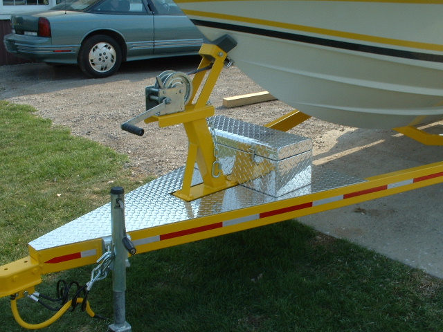

finished painting my trailer a few days ago.. got the boat back on it today Here is my home depot trailer box

traviss, looks GREAT!!

I agree!
How did you attach the diamond plate?

thanks guys the diamondplate is rivited to the trailer. In between the plate and trailer I used rubber washers to isolate the aluminum from the steel. Came out better then I thought
