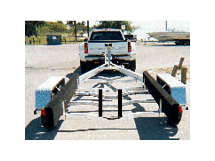

The ACE alum. trailer my stepped 288 sits on has two notched 3x10's for support half way between the V and the Chine from the rear just forward of the step, then in front of that it has two 2x4's down low for support of the V, I'm wondering if I should add some additional 2x4 bunks to support the V in the rear, since my boat now spends most of its time on the trailer ????
Here is what my trailer looks like...

How about keel rollers on those crossbars?
You have to be careful- too slippery can work against you. make sure you have more straps than you think you'll ever need.

Chris,, I thought about adding two keel rollers, as that would be the easiest thing for added support, but the 288 has a large pad, so I dont think thats the way to go... ??
I had 2 different pad-bottom Velocity boats. Stepp recommended keel pads on the trailer. Both had 8' long planks about 12" wide, then 2 keel rollers forward.

Definitely can't hurt, as long as you don't place them where they will interfere with the step when loading and unloading.
Chris,, If I read this correctly,, basically your trailers had a " pad " bunk ??? so in addition to my two rear bunks I could make a flat carpeted bunk that runs up the middle of the trailer from the rear supporting the pad of the boat ?? if this is correct sounds like a good idea and pretty easy to accomplish.. thanks chris..
Exactly. 3 rails in the rear- one on the left and right just inside of the hard chine- probably 2x6's, then one down the center that was either a 2x10 or 12. They were only 8' long (on a 30' boat) then 2 rollers up front following the curve of the keel to dampen trailer flex. It was set up pretty well- the boat always found its proper spot on the trailer.
