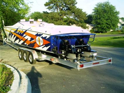

Here is a photo of mine. I like it and it looks bad azz, but I am always a little nervous backing it into the water when the boat is already at the dock with all of that aluminum sticking out there 5-6' past the bunks.

If it was me I would not weld it onto the existing frame. I would bolt it on. That way you do not have any issues with rust.

I remember at a race that a team got rear ended on the way down and the drive guard made it so that they could not get the boat off the trailer!!
still beats diggin the drives outta the bilge!
