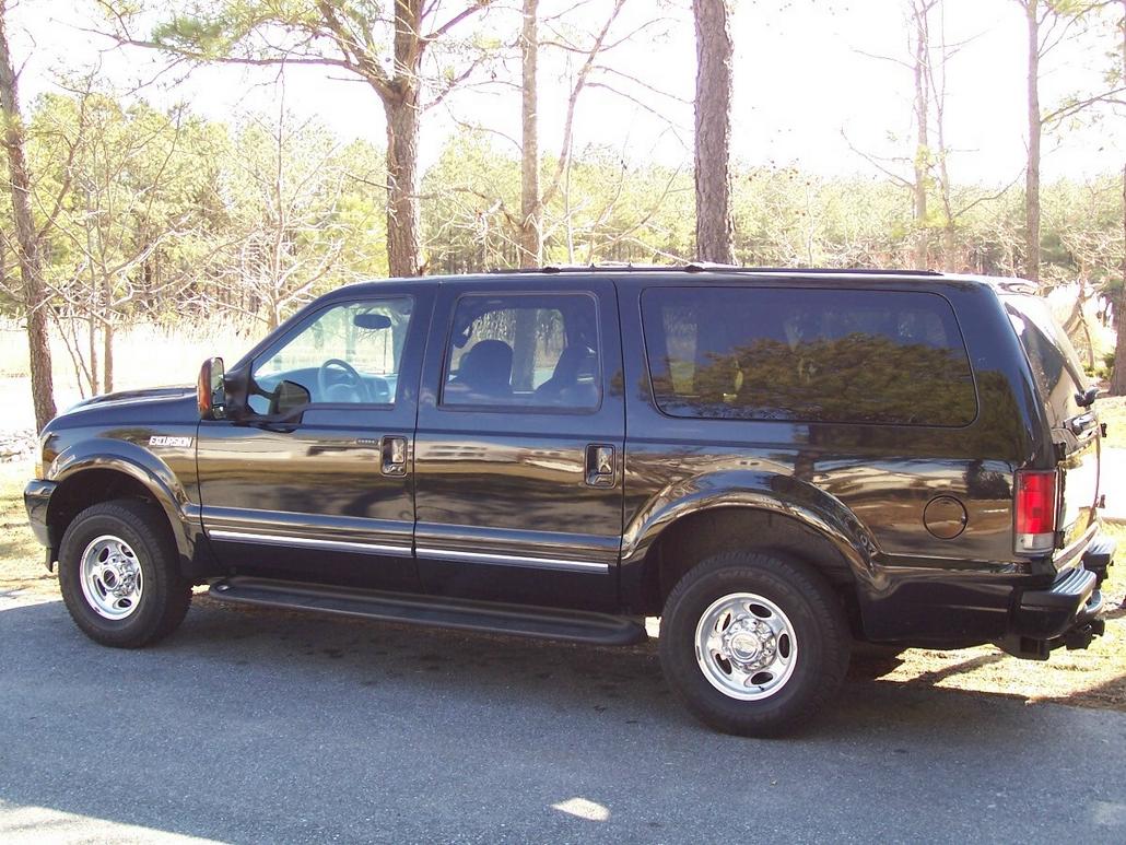

Here's a pict

Nice looking truck. Cherish it- they don't make them anymore, and never will again. Mine gets put away in the fall and doesn't come out again until spring. Salt is not its friend......
