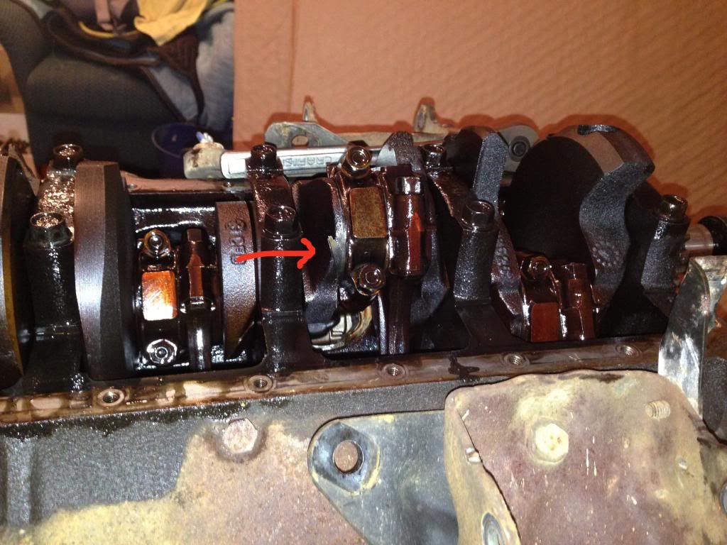

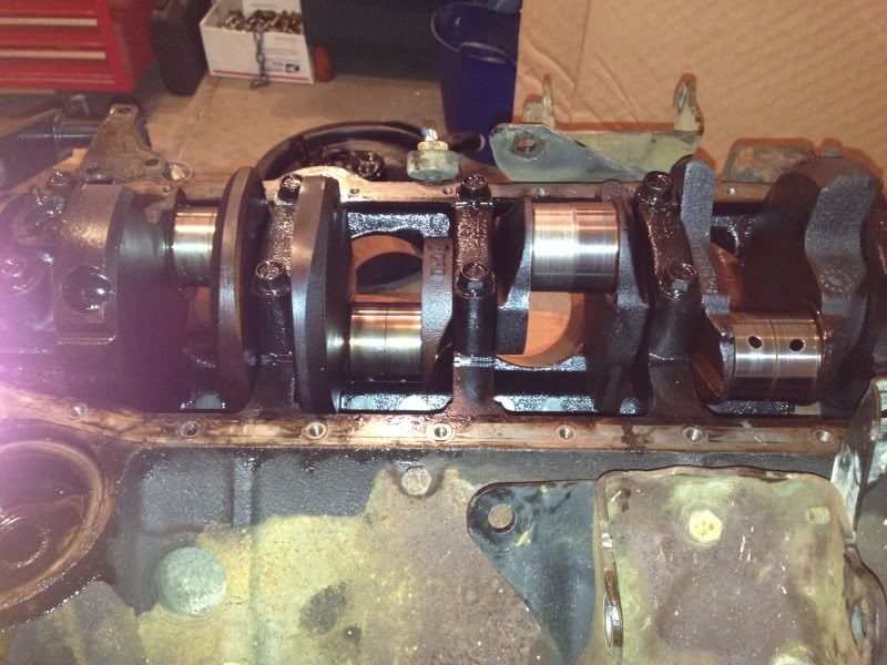

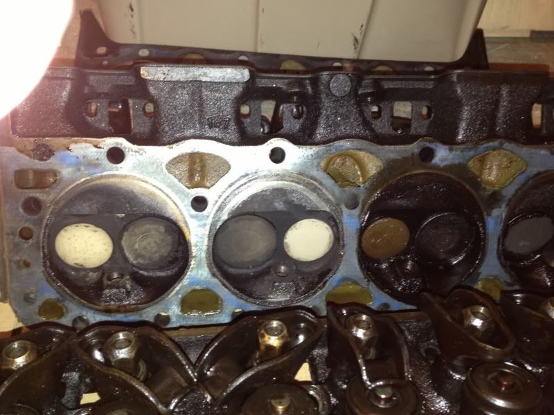

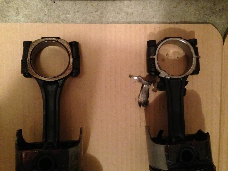

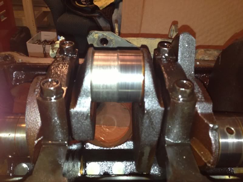

Pulled the motor and did the root cause today. Number 4 rod bearing spun, and spun, and spun, and spun. I bought this truck probably 8 years ago, I knew the engine was fried then, never thought it would last as long as it did. It did make a last trip to the landfill about 20 miles each way, knocking the whole way. It was funny to see people's reaction when I would drive by.
