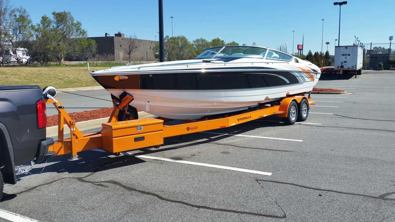

Default trailer
Consider a driver guard assembly with lots of lights! You can make 'em swingable or removable.
This one swings open.
This one has a removable cross beam.
