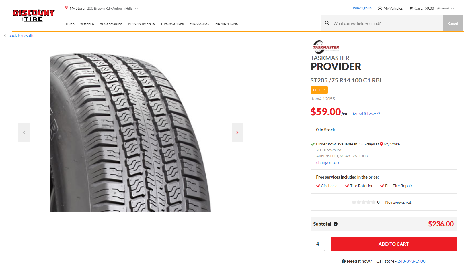

I was looking at these tires and thinking they were car tires but I think the "ST" means "Special Trailer". Any opinions on these tires? They have fairly high load ratings and the price is good.
The most important thing about trailer tires is how you treat them. Any of them will fail with improper treatment.
Air pressure, obvious.
Monitor for temperature when towing. Take temps every stop. Is one axle's tires hotter than another? Too much weight.
Parking on dirt grass is HORRIBLE for tires. Concrete, pavement, shingles over wood, teflon sheets over wood, plastic roofing panels, gravel, in that order are IME the best options for parking trailer tires.
AND you have to cover them from UV rays, including the spare tire. I recommend the foil covers from Amfor sold on Amazon. I have dozens of them.
This kind of crap is "not in the manual", but you learn it over time.
And IRT to the OP...
The best thing you can do at this point is upgrade to 15" wheels and tires. AND go to a D or E load rated tire. Both Maxxis ST tires and Rainer ST tires have been GREAT for me for the past few years on my trailers. They can both be bought in D & E load ranges in 14" and 15" respectively. And I am running Goodyear Endurance tires on my big toy hauler now.

I appreciate all of the replies. My boat is always stored indoors on concrete and the trailer sees well under 1,000 miles per year. It does sit all winter but so do 3 cars and those tires have never failed because of it. Two votes for Maxxis so I am looking at those. Not going to buy new wheels at this time as the 14" wheels are nice aluminum wheels. The same size Maxxis as the Taskmaster that I posted are load range D and are quite a bit more money at close to $100 mounted and balanced and old tires disposed. I have to think about this because the Taskmasters are $236 out the door for 4 and the Maxxis would be $400 and will they both last the same length of time? Time flies and the new Marathons have been on for 8 seasons so about 8,000 miles. I still don't know why they should have catastrophic failure like they do. My boat isn't that heavy and the bigger tires do not flex going down the road like the smaller original tires did.
