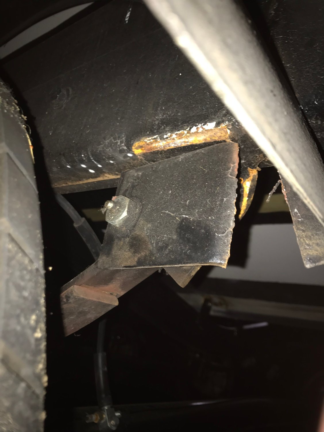

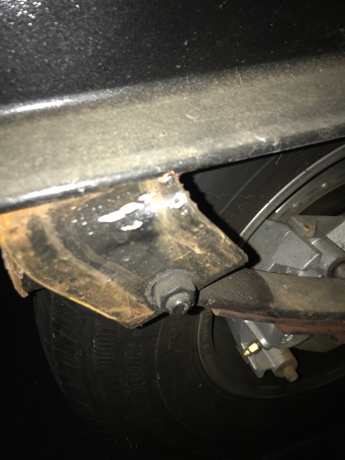

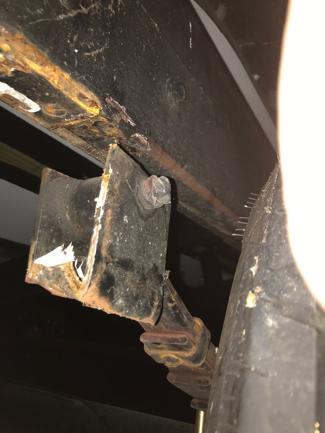

I have the same issue with my triple axle, what works well is to wet down the pavement and tires with plenty of soap. I usually hose the area then mix up a couple of 5 gallon buckets with dish soap, lots of suds, then dump it on the pavement, the tires slide much easier.
I actually tore the spring perches from the frame on the rear axle before doing this.
