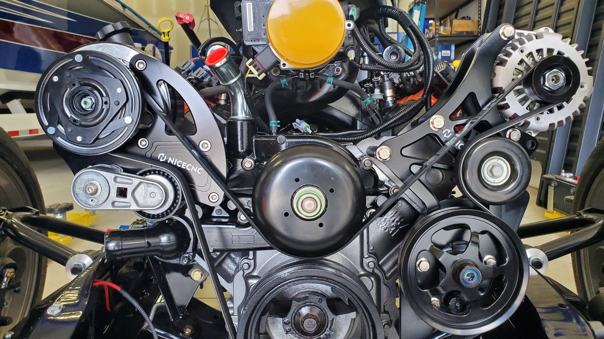

bit of a mock up of the relocation brackets, AC upper left and Alt and PS on the right

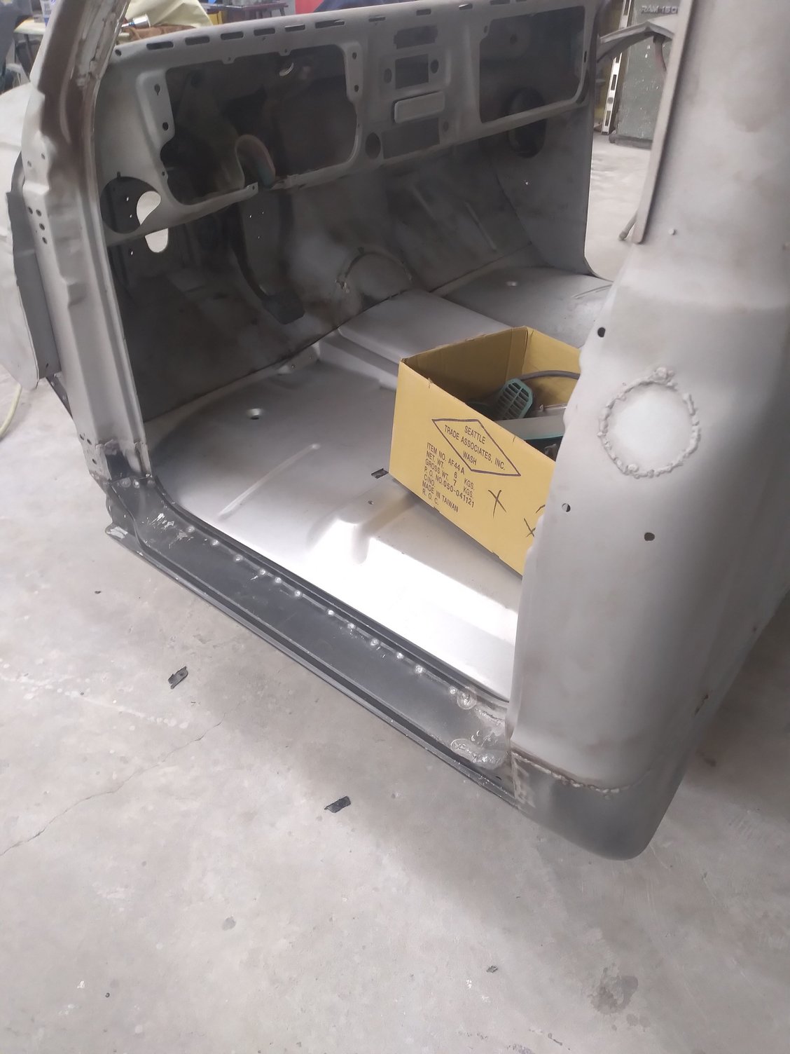

Some progress, took the cab to Tx friend of my brother in-law is doing the repair and get it ready for paint, think Im going to do flush glass on the windshield and rear.

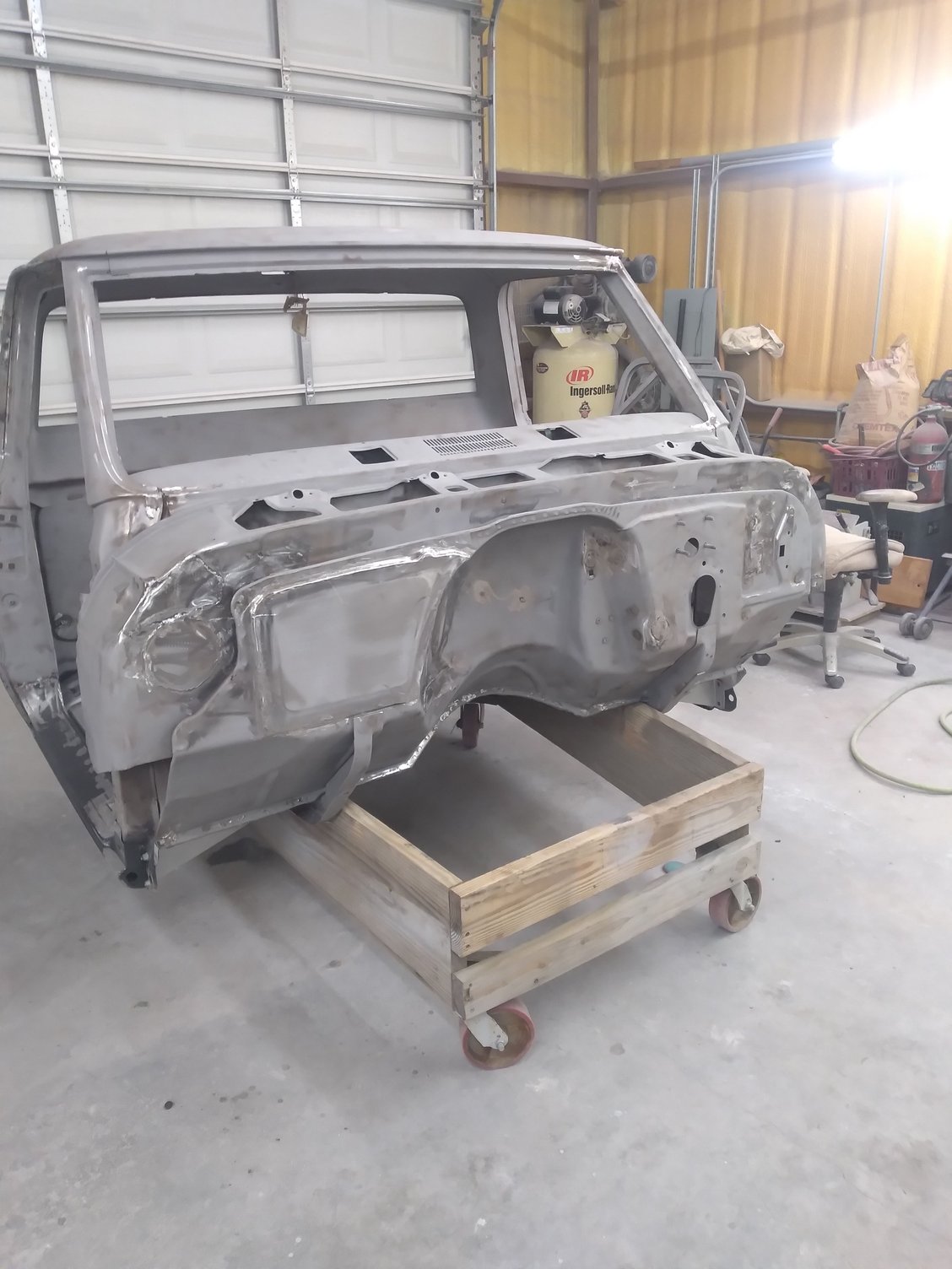

cab is blasted most of the metal work is done hope to be in primer in a couple weeks, then color in the jambs, firewall and interior

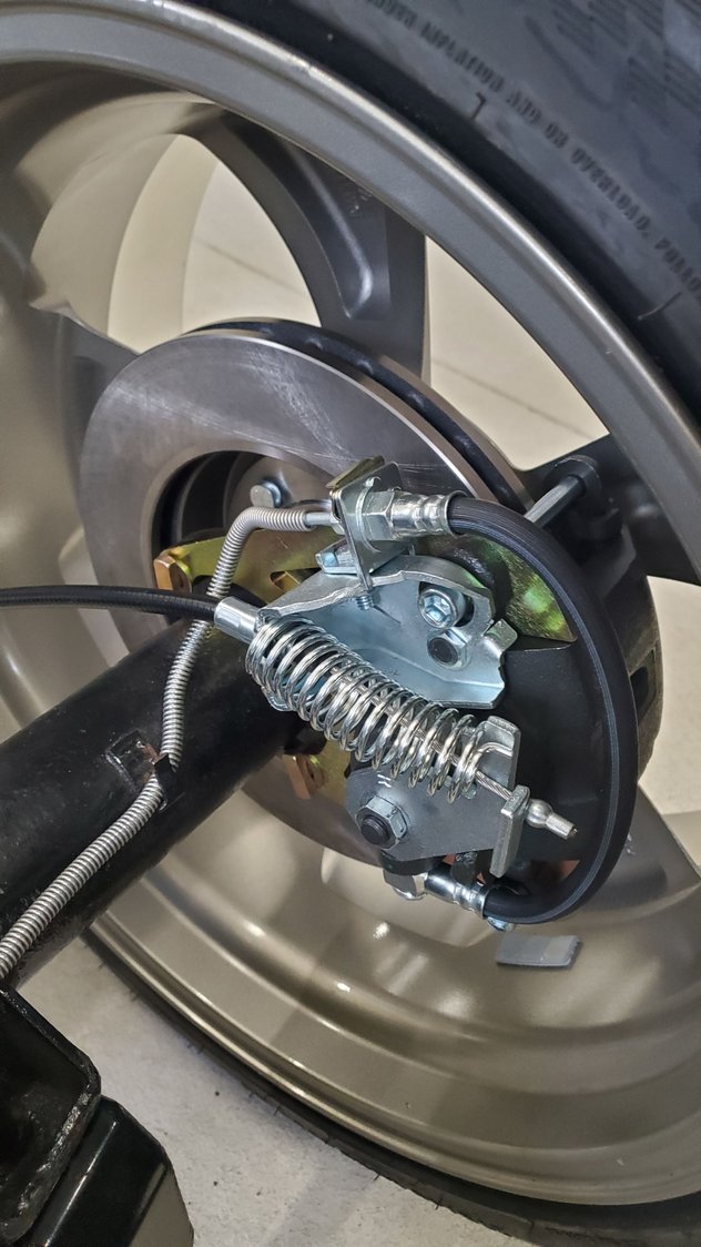

rear disc conversion done

this is just a question as I have dealt with those calipers quite a bit. did you adjust them before putting the arm for the e-brake on? also if this is an automatic make sure you use the e-brake regularly with that setup as they will not self adjust if you dont and the ratchet in them will stick and you wont have rear brakes. if you already know about all that then you are ahead of most who use them. truck looks like it is coming along nice. I finally drove my 60 caddy LS swap. few things left to do but for a stock 5.3 it runs pretty nice.
