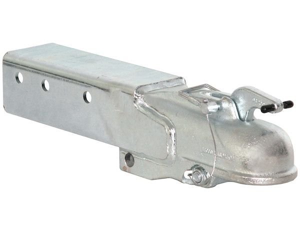

I went with Hydrastar for my triple axle.. hubs, actuator and ALL for just over $2000.. works GREAT .!
As far a coupler.. I went with a Buyer's product unit.. BEST coupler I've EVER had.. hitches and unhitches EFFORTLESSLY . !
