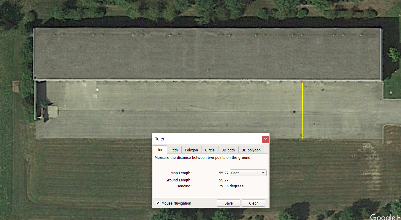

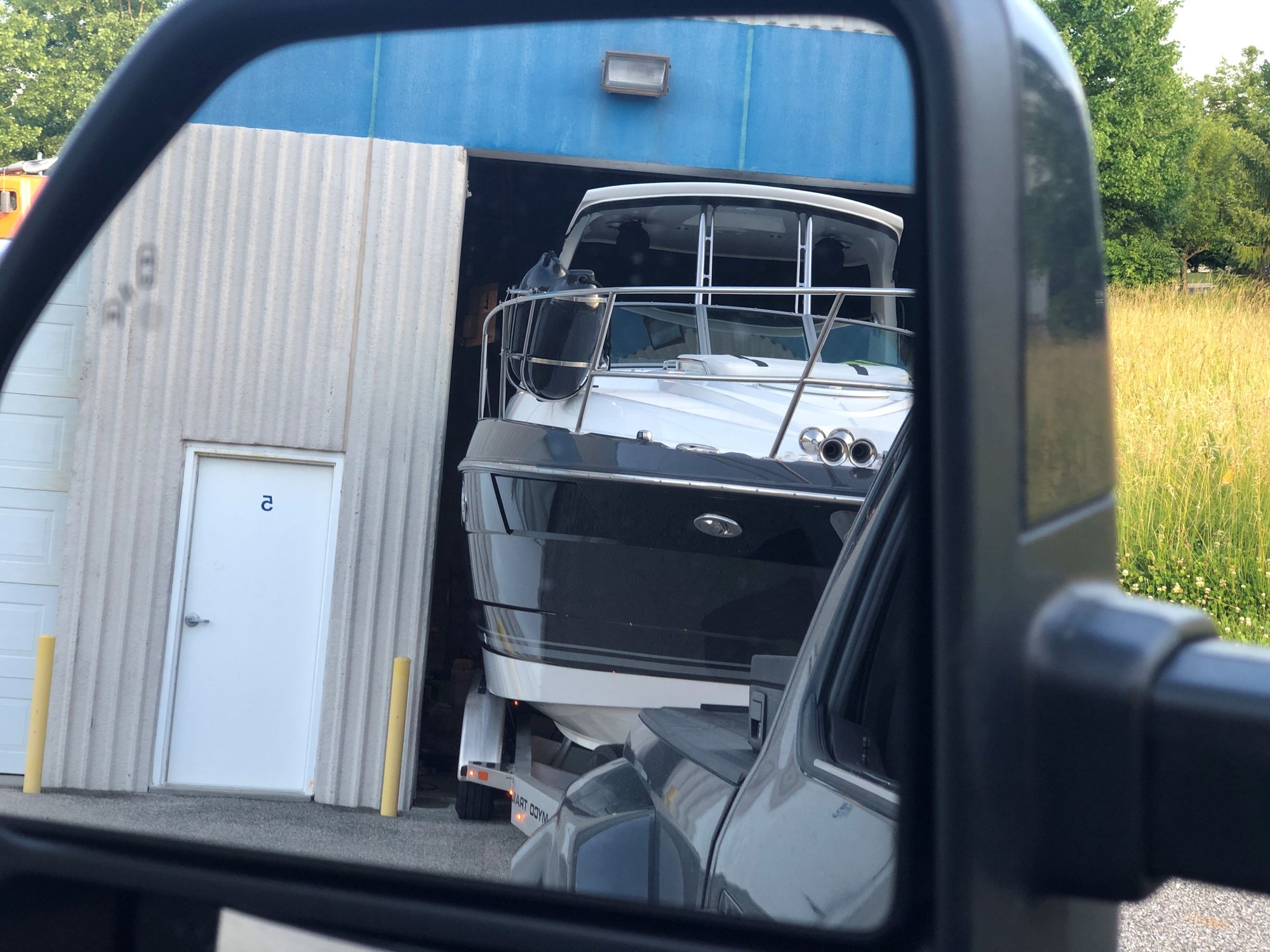

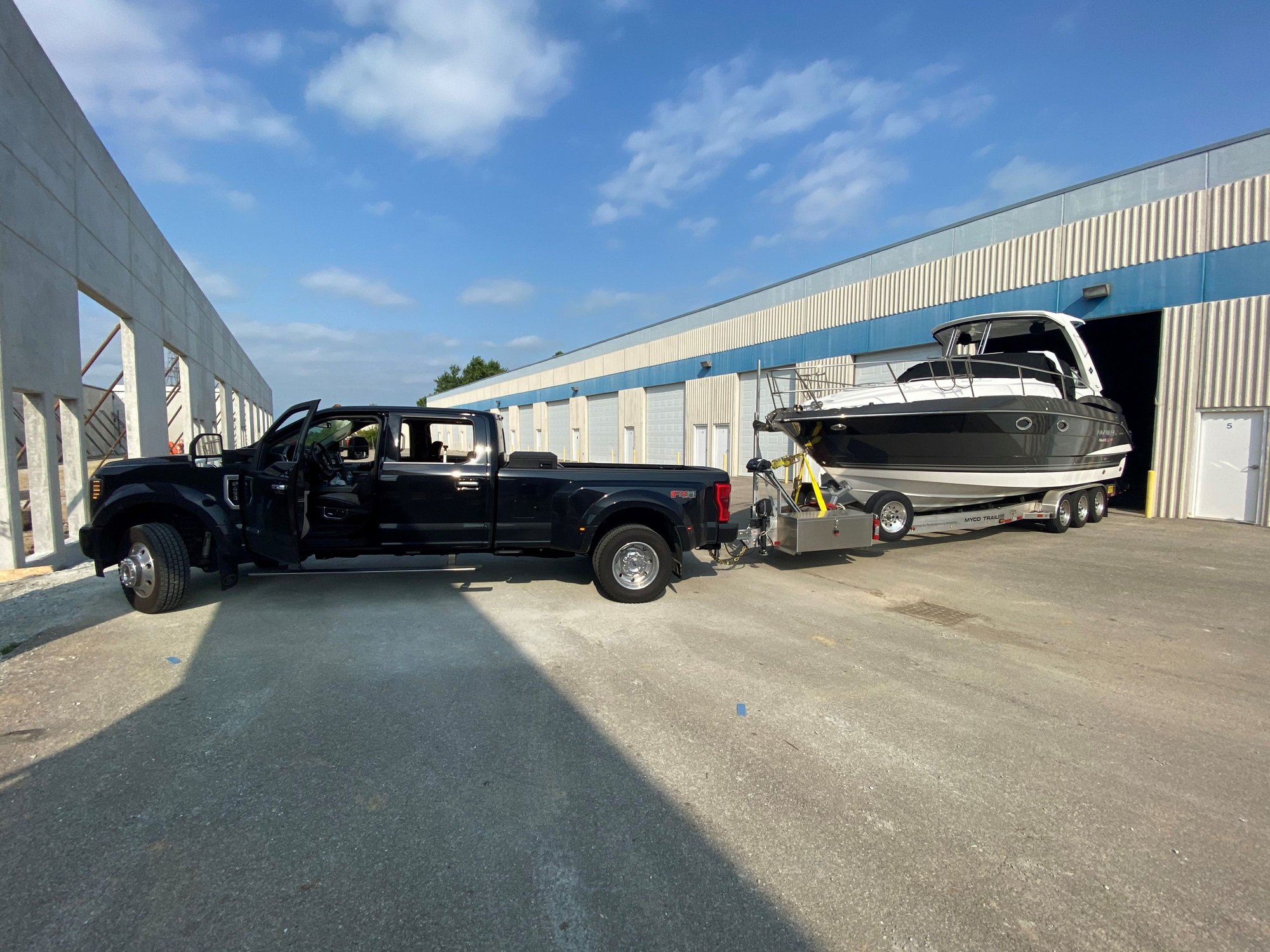

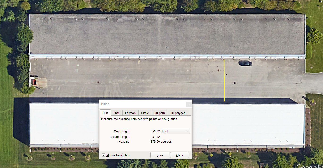

I have a similar issue. My storage condo has 51' between yellow concrete protector pylings (or whatever they are called). When I first bought the storage units, there was no second building across from it and there was about 55' of paved lot, plus I could cheat and go in the grass a bit. My door is 12' wide and the boat's beam is 10'11" so barely 6" of room on either side. My trailer is 38ft, gen Y hitch is a foot, and truck is 22' so total length of 61'. Fortunately I keep the boat on a lift at a marina in the summer, so when I trailer it to other areas I only have to deal with putting the empty trailer back away. That's easy. What sucks, and what is extremely hard on wheel bearings, is backing the boat for winter storage. In fact, I'll be doing this tomorrow. I like the idea of wetting the ground with soapy water to help with this. Not sure how much it will help, the pavement isn't the smoothest. Open to any other suggestions.

I do have a front hitch, which holds my front oversize load sign. The problem is it is just a 2" curt hitch rated for 500 lbs of tongue weight. I have about 2,200 lbs of tongue weight.

Don't put all the weight on the hitch then. Put the tongue jack foot down on heavy duty wheel/tire dolly. Or swap out your the tongue jack foot to wheels:
