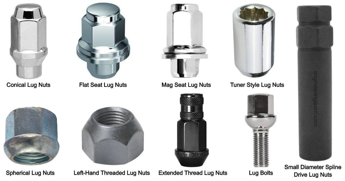

Ayuh,..... That wheel looks like a uni-lug, multi-bolt pattern wheel, as the holes are slots, not round,.....
They take special washered lug nuts,....
Bondo is offline
Old 07-21-2024 | 09:20 PM
Joined: Aug 2010
Posts: 1,386
Likes: 565
Just a little more expansion on that, not only washered but also shouldered lug nuts.
As in the 2nd and 3rd from left in the top row.
Hate to see a guy just pop some washers under the nuts when they need the shoulders to "align" the wheel.
