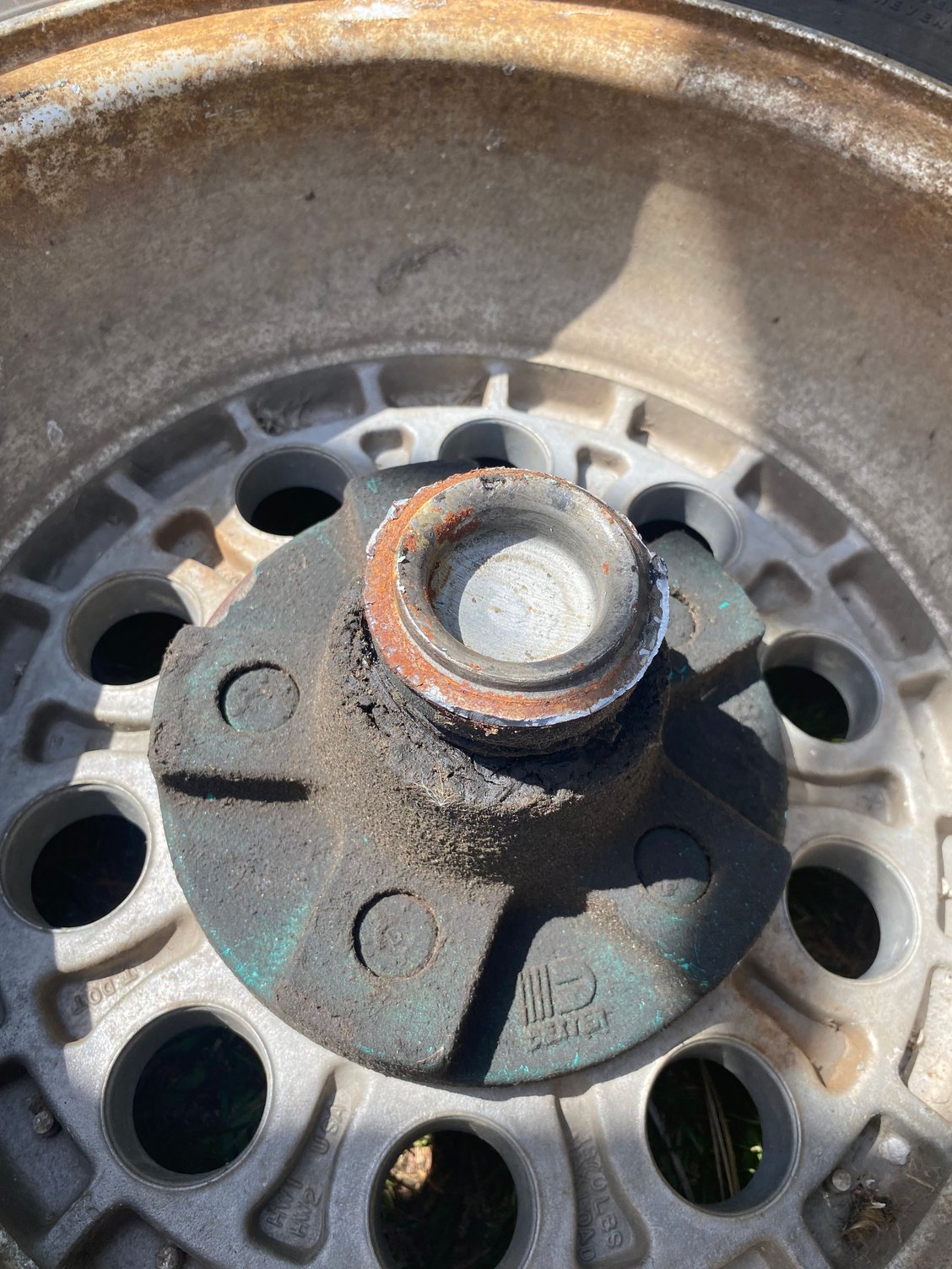

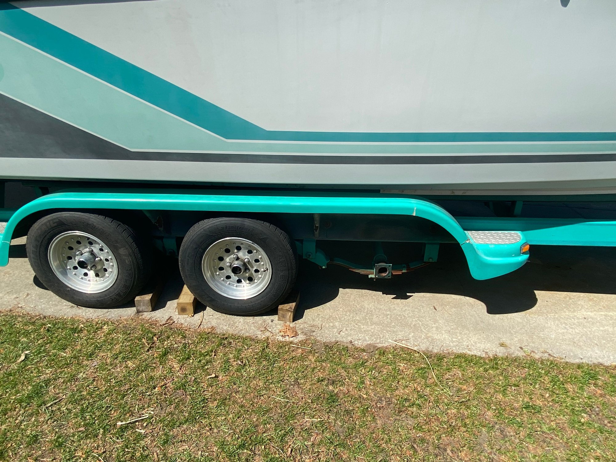

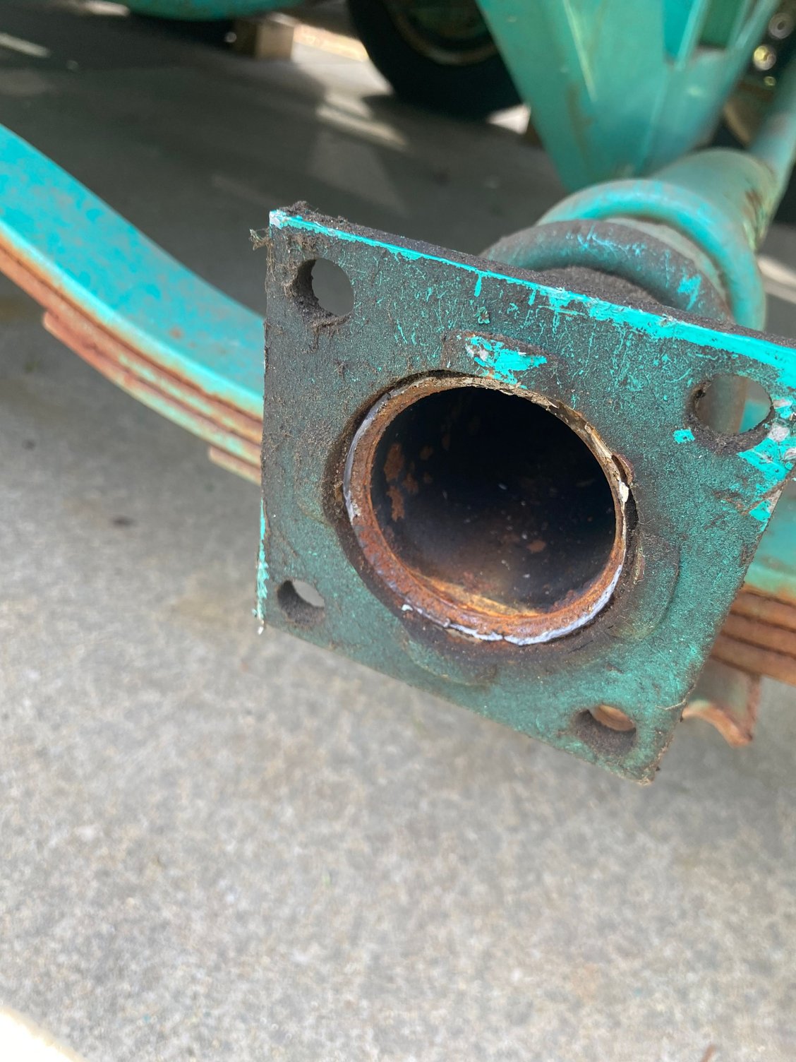

so I got brought the boat home for some pre season maintenance and when I was backing it into the driveway the wheel hub broke off the axle. Unfortunately I don’t have much of a choice but to make a hard cut into it. In hindsight I should have sprayed down some water………. Anyways what’s the repair options here? Weld on a new hub or replace the whole axle.

From the photos...it appears the cast spindle wasn't properly welded to the axle tube.
This could be lined up and re-welded, but maybe easier and cheaper to just replace it.
There are places that repair axles.

You would be surprised how inexpensive those axles are. I would definitely replace.
These are just an examples of 3500 lbs, axles which is what it looks like you have. You will have to measure to spec the right width.
You may have a bit better luck with shipping via ordering from a local trailer shop that regularly gets truck shipments. Yes, they will mark the axle sale price up, but it MAY be less than shipping.

That looks like a 29 power quest so Integrity built that trailer. Try them or Mid west for a repair< they are also on M104.
