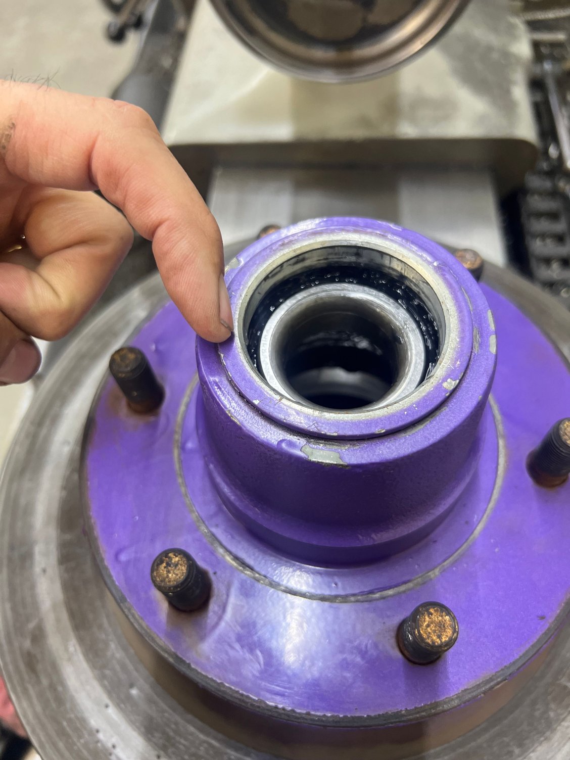

Guys,
I went into the shop this morning, thinking I’d get the hubs disassembled and cleaned up, ready to install when the time came. But I’ve hit a snag…,
I can’t get the outer bearing out. I’ve confirmed the bearing itself is ~.150” larger in diameter than the opening I have to get it out through.
There appears to be a reducer ring/spacer installed to fit a specific size Bearing Buddies:
Anybody ever seen this? How would one go about getting this out? Just press it all out brome the back at once? Bearing, race, reducer and all?
Thanks. Brad.

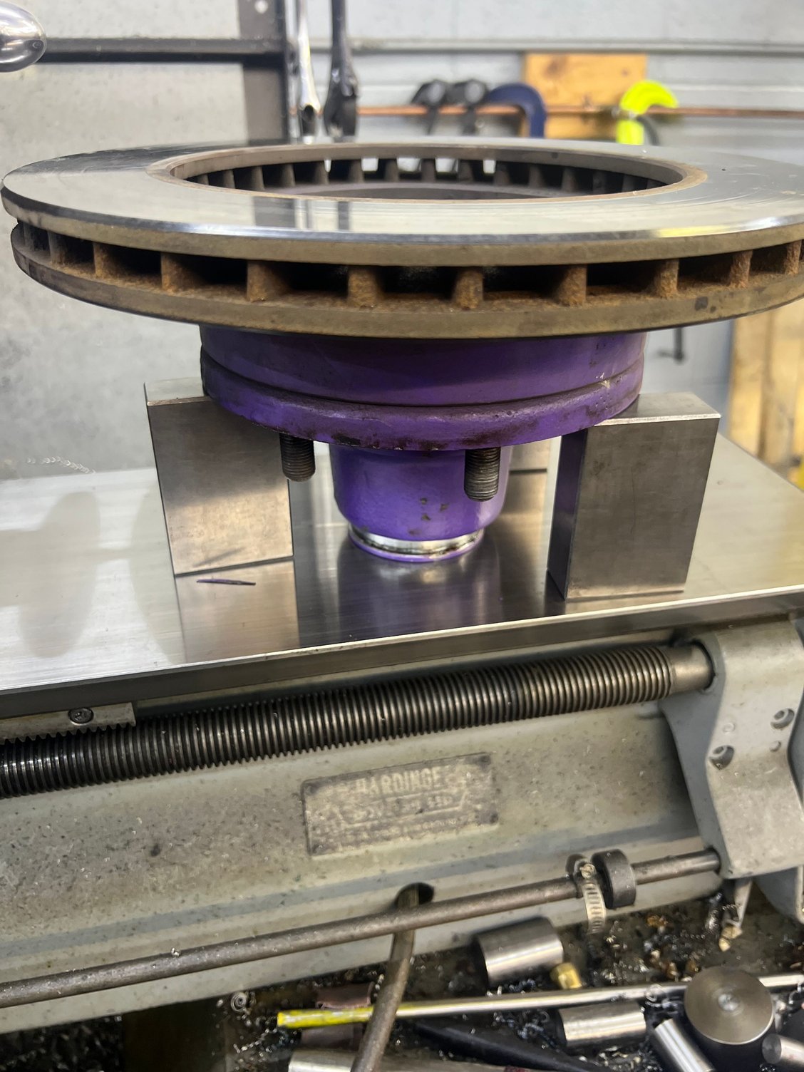

Powerboatr,
Yup. Upon suggestion from the rep at Heritage, I stacked the hub on some 1-2-3 blocks here at the shop and pecked it out with a slug of brass.
(Pay no attention to the mess on the lathe
I’ve since driven the old races out and the new ones in. When the rest of the parts get here, and I get the axle install done, I’ll move forward with installing the bearings and seals and getting the hubs installed.
Thanks. Brad.
