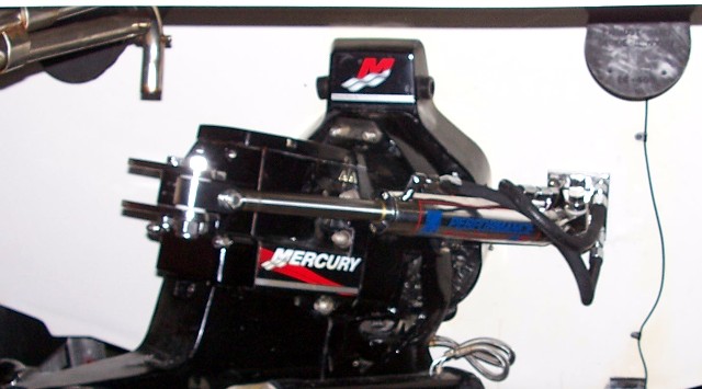

I might need a short tutorial.. here r some pics with the steering system. when i brought the boat it was alreaedy installed, so i'm abit clueless ..also the drive is facing off center, so would have to straighten it, then bleed the lines, then add oil..Thanks, as u can see, i need help here..lol

The easiest way I have found is to first fill the power steering pump res. Then start it up and spin the steering wheel back and forth a couple of times. Then shut down and refill the res and repeet. The oil may get foamy so you may have to wait in between. If you have help, you can fill the res while the engine is running and have your helper spin the wheel back and forth.

Her another if it will help, not 2 sure if this system has the pistons..

Yes you have an external piston steering system.
It will use the powersteering pump on the engine and the hydraulic helm behind the steering wheel at the dash.
