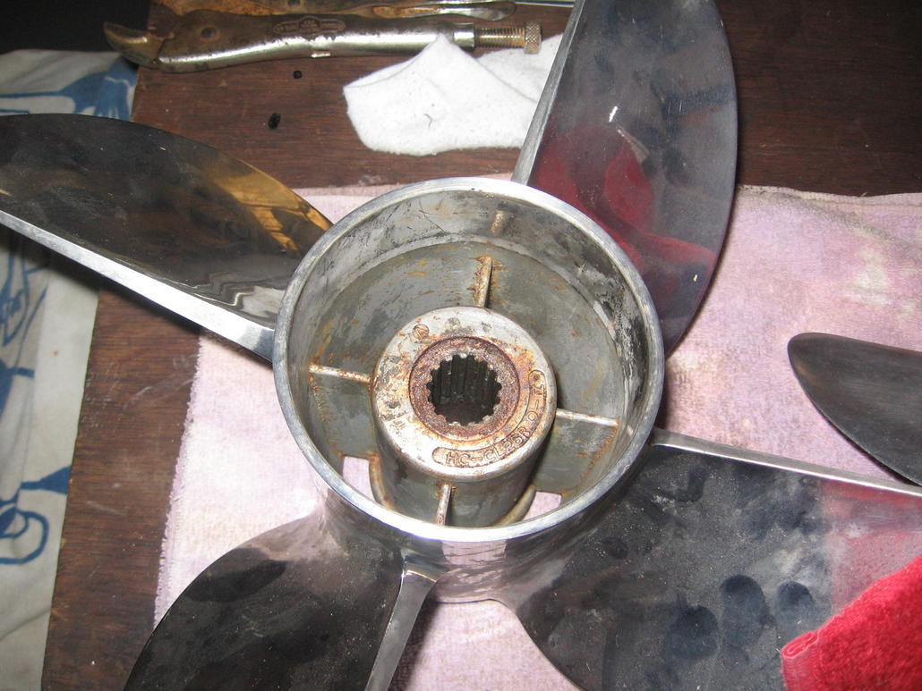

Hey fellas,
It's been awhile since i've posted any updates, but the mechanic can't get to the motor until the end of the month, so i've been sitting back waiting patiently,
but i do have one question, i was able to borrow a prop fom a mate of mine to try(a 26p hydromotive), the only thing is that, it has the permanent hub in side the prop. does a spacer go at the end, because when i put the prop on it shows about 1/2 inch of the shaft before u get to the threads. or how can i retify this. with my 24 hydro it had the external hub which took up the space behind the prop.
thanks

Originally Posted by qaberdeen
Hey fellas,
thanks
Yes, you will need the splined spacer and lock ring on the end of the prop. I will try to find the part number for you later tonight!! May even need a different washer in front of it. I don't remember what I have on mine..........

Thanks Dkerns, I was able to get another spacer for the front of the prop. Now i'm just waiting for the mechanic to come and lace this bad boy up..lol
