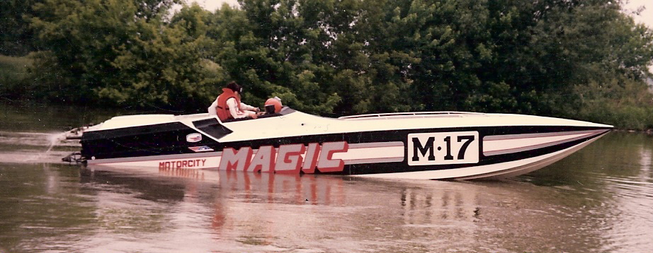

And here is a little more history. Back in 1986 our race team [M-17 Magic] took delivery of a new 33' Image [EXPRESS] cat to race in the APBA modified class. With our in house built 550hp 372cu chevy eng & merc speed III's she would run 110mph. Her sister cat the Baja Bandit with merc power [about 510hp] & speed IV's ran about 108mph. These were great hulls. When Bob Kehrig retired from racing he sold her and may have raced as Bad To The Bone, after that we lost track of her. That was until the 1991 Key West Worlds, when she became the 35' [now with the add on beaks] open class Ray Ban Sunglass cat. With big block Merc power she was one of the fastest in open class. Sadly she flipped or stuffed in the first race never to race again. I believe there was one more built like this to race by the name of KAT that raced open class that may have become this one Screaming Eagle. As I said these hulls were fast and never needed much if any trim tabs. My only suggestion would be to add a brace [about 15" up from the bottom] in the sides of the gunnel in the engine compartment, we blew our rear side out in 1986 and then added them.

H20, there was also a 35 built for the late Randy Linebach back in 90/91 i remember seeing it at the shop, randy never took delivery because he wasn't happy with the build this could also be his hull. I heard that your old 33/35 sat in fla for years after the key west accident. Wonder what year the trailer is looks like this boat is the old screaming eagle. baja became KAT

but that was about 5 years ago, today ???????? John Avery lives down there now but has'nt been abel to find her. Some one dropped a new blank 33' Express off at the end of my street in a vacant lot, it would make a great retro Magic. I put Rob K on to it,, you never know.. Randy also had a Warlock cat that he didnt like much ether.. Are you down in Florida now with the rest of the Michigan boy's ? Big Wave and I are ready to come back down, but I think it's has been warmer up here..
