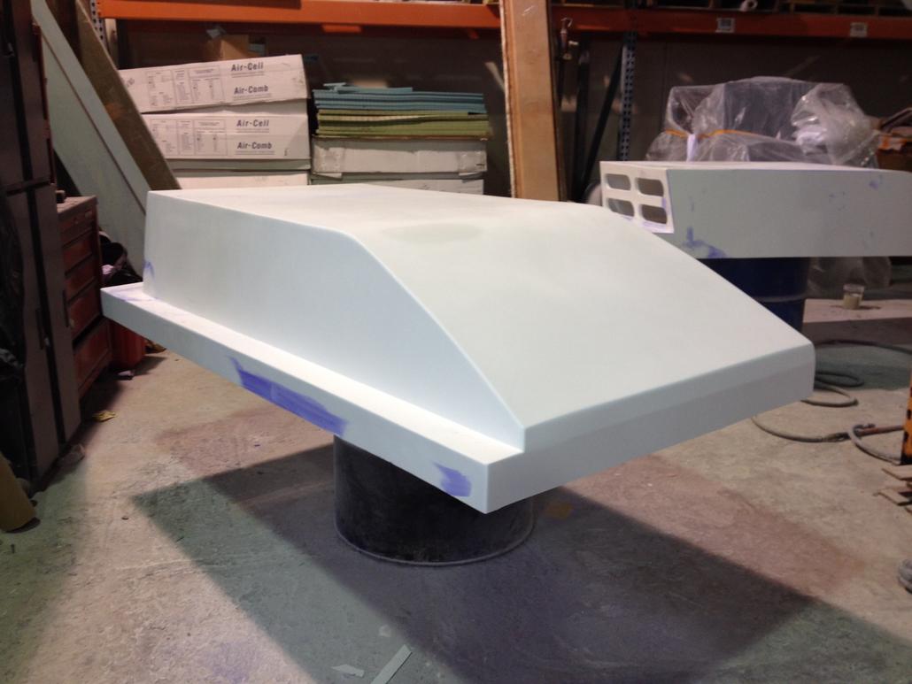

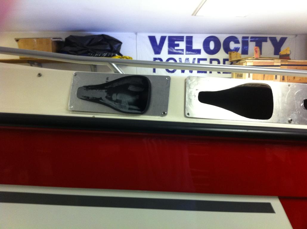

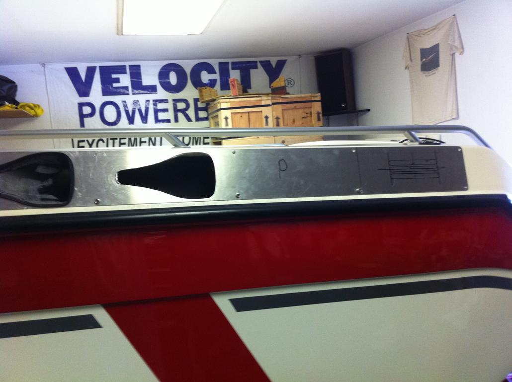

Thanks guys. Doing everything we can to make the VELOCITY rally in june.
Velocity sent some pictures of the hatches. Almost done.[ATTACH=CONFIG]519403[/ATTACH][ATTACH=CONFIG]519404[/ATTACH][ATTACH=CONFIG]519405[/ATTACH][ATTACH=CONFIG]519406[/ATTACH][ATTACH=CONFIG]519407[/ATTACH]

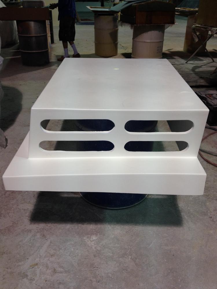

Decided to get rid of the old air scopes and install some naca ducts. Used .080 aluminum, Going to powder coat the aluminum and paint the naca ducts to match. Cover up old square holes and install naca ducts. In the rear end of the piece of aluminum, I'll cut 3 -1/2" x 6" slots for the bilge blowers. Should look much better than before. Bob[ATTACH=CONFIG]520024[/ATTACH][ATTACH=CONFIG]520026[/ATTACH][ATTACH=CONFIG]520027[/ATTACH][ATTACH=CONFIG]520028[/ATTACH][ATTACH=CONFIG]520029[/ATTACH][ATTACH=CONFIG]520030[/ATTACH][ATTACH=CONFIG]520031[/ATTACH]

Bob I estimate that your motors will need 2,345,876 cubic feet of air per minute at 5000 rpm. I think you'll need a few more ducts.

Steve, Steve Stepp claims 1 naca duct on each side for 500 hp, so given that, I think we are good. But we could always add 2,4 or 6 more.... What do ya think?
