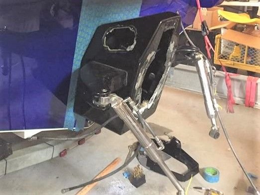

I picked up an HD transom assembly.. Puts me one step closer to an SCX upper..
and should prolly be running one anyways with the power and speed I'm at..
I ALSO Picked up an Imco extension box..
Seems a 12" box and a -2 shorty works well on this hull ... I'm going to find out....
