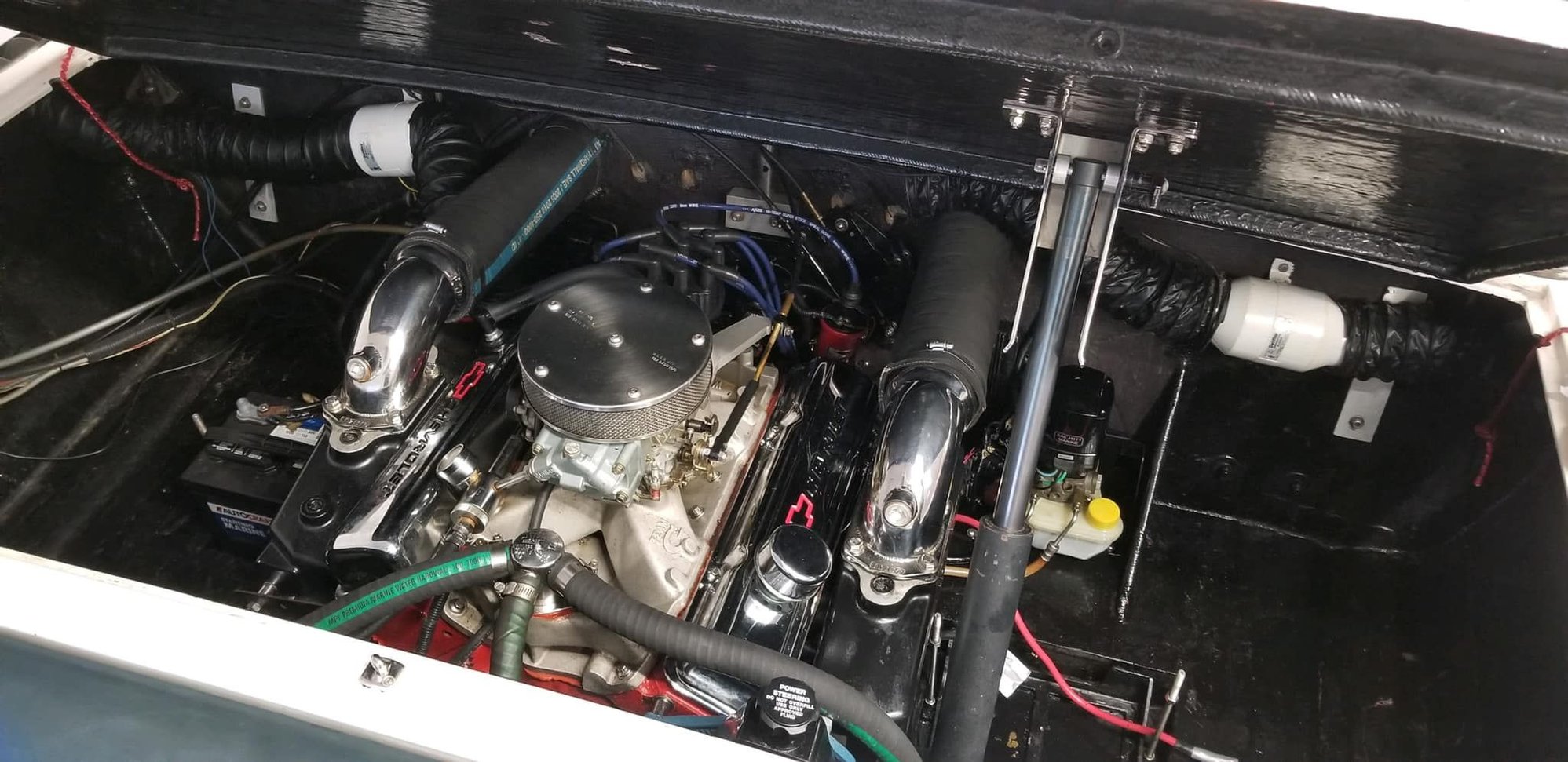

I am doing a restoration to my 1985 Velocity 220 with a major redo over the off season. I've been taking care of a few things that can be done during the season and one of those is a new better breathing exhaust. I decided to go with a Stainless Marine Hi Torque 4 inch exhaust. A step up from the basically stock HGE-7114-A with Imco 4 inch stainless riser that were on the boat. I notice that the exhaust was kind of flat from the manifolds back to the tail pipes, and I was right. When the Stainless Marine exhaust is used you first bolt on the manifolds and then take a number of measurements and email those to Stain Marine. They then make up the risers from the measurements you supplied. I was contacted by Jerry and Letty yesterday from Stainless and they showed some concern with the lack of drop in the exhaust since I only have so much room under the deck and I really don't want to cut anything. I'm also against a dry exhaust. They told me that there were some tricks they could use to minimize any reversion issues by adding an anti reversion ring and moving the water tube back farther closer to the tailpipes.I never had a problem with the old exhaust, but a new engine will be built over the winter with a much more aggressive cam profile and obviously I don't want any reversion when the new and expensive engine goes in. Does anyone have any suggestions, trips or tricks in dealing with this issue in the older Velocity 220s. TIA

Mercury Racing gives out installation instructions for their motors and exhaust for just the reason you are asking. They don't want reversion either. To save you time looking it up, they tell you that on a basic stock motor (350/454/502 etc) you need at least 13" from the top of the exhaust elbow to the waterline.
On a performance motor they want 15" from the waterline to top of elbow, and a minimum of 1/2" drop per 12" of exhaust.
If you can't get to those numbers with the stock locations then you are going to need to do dry or some other "fix" to eliminate the risk of reversion. I'd ask SM if their suggestions are just going to help, or if its going to stop reversion. I'd ask your engine builder and cam picker the same questions about reversion.
