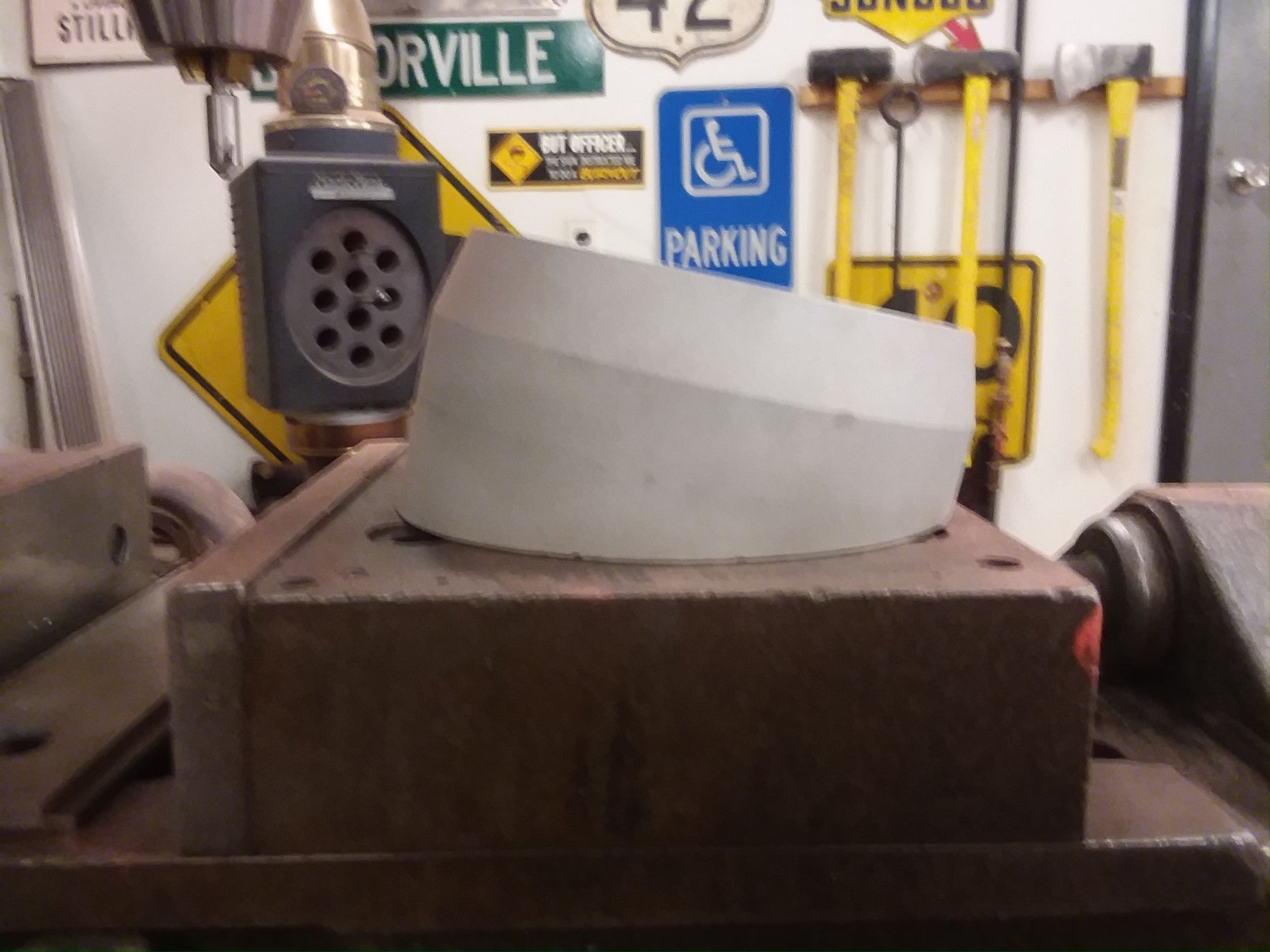

I had to make one. Machined for the front and just glassed in a wood wedge on the back. To get something like 10* it adds 3" to the thickness of the dash, so you may need a spacer for the steering shaft also. I will see if i can find a pic of the spacer for you.

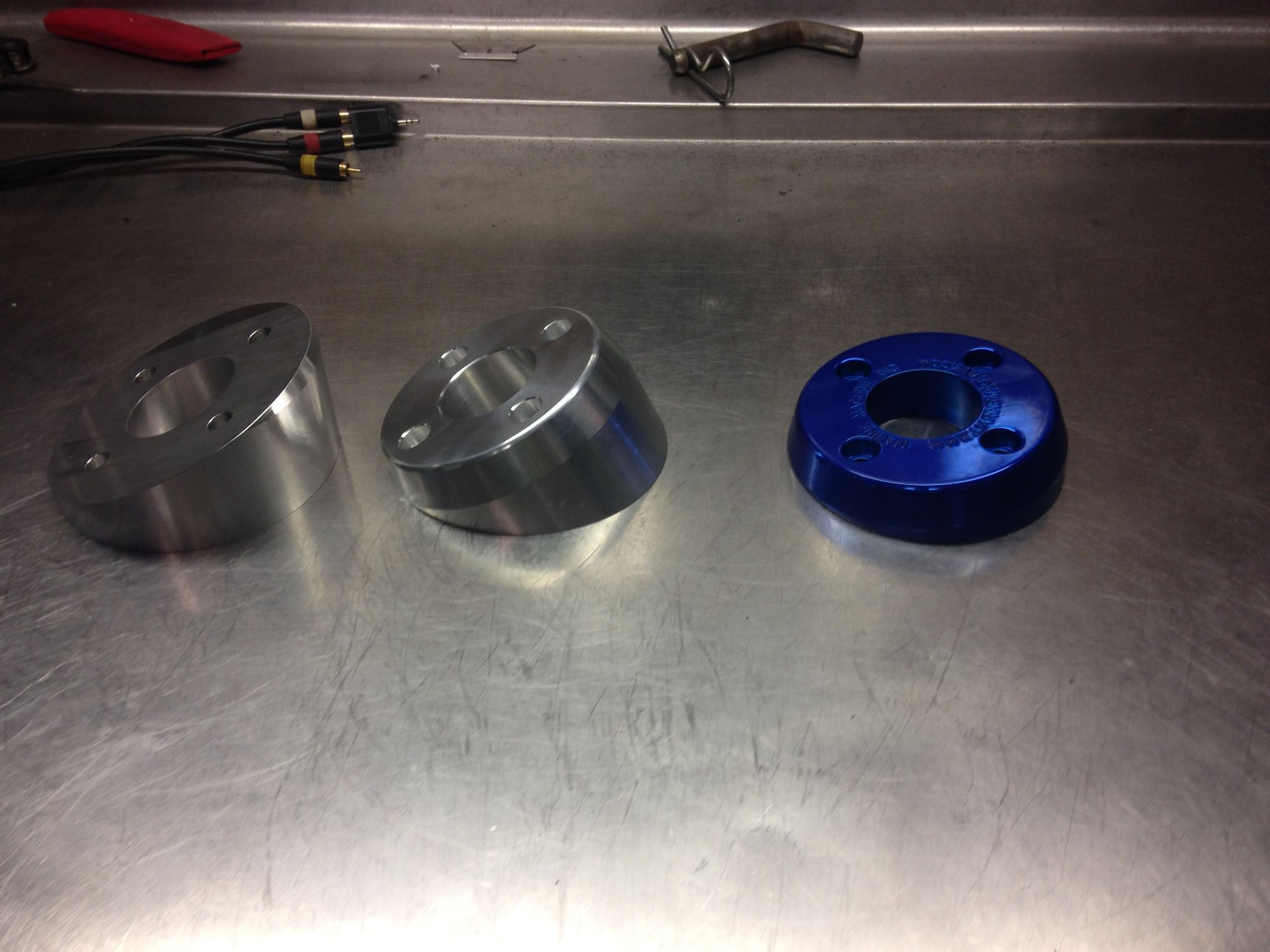

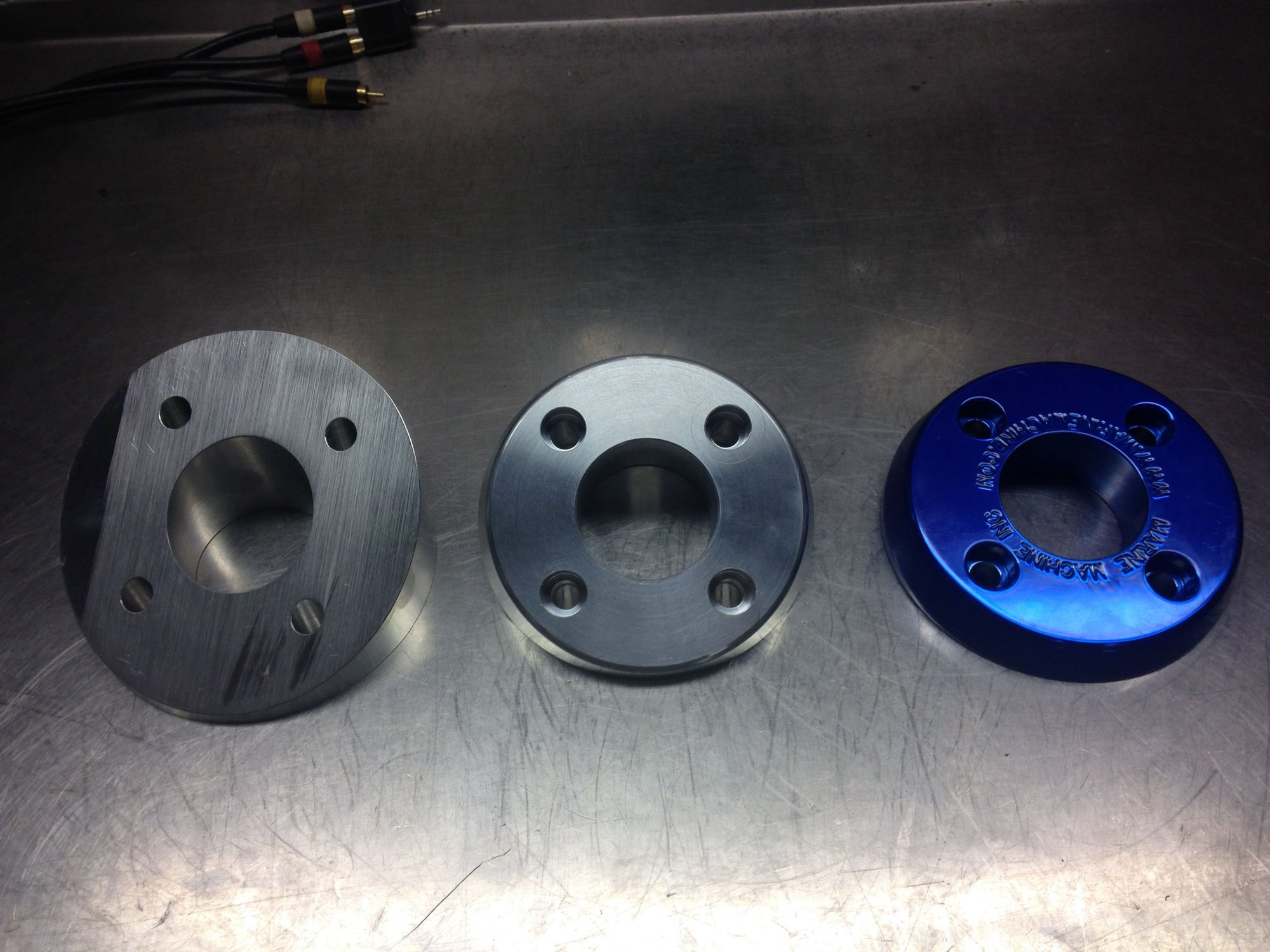

had one made by a local guy to me. Top notch general machinist. Very reasonable, just tell him the angle you want and he will make it. The blue one was a 8* wedge that I had laying around that I gave to him for a guide. PM me if you want his contact info.
mickeymcclgn is offline

I screwed it to the bottom of my existing shim....
You can kinda see the line on the bottom where the shim is attached
