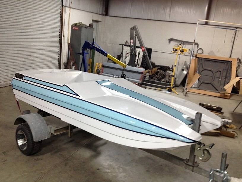

Old 01-08-2025 | 08:54 PM
Joined: Jan 2007
Posts: 2,087
Likes: 1,211
From: Murrayville Georgia
here is my Cub
compedgemarine is offline
Old 01-09-2025 | 05:44 AM
Posts: 4,472
Likes: 2,109
From: Milton, Fla!
Very cool!
Should be an absolute hoot!
Originally Posted by compedgemarine
here is my Cub
Twin O/B Sonic is offline
