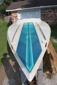

Were you running your Euro in the Ocean or the Lake? The hull sends up a large following sea coming off plane even when being thoughtful. If it were me, I'd convert it to OB power
