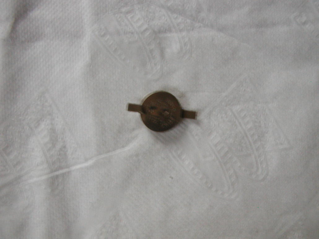

Here the new battery cost $3:90 Batterys plus has them you need to tell them to put the tabs on the battery.They said they would install it for $10.But I'am going to solder mine tomorrow.One my friends bring in his solder sucker solder pencil.I will let everybody if it fixes the problem.

Mines dead also. What a crap setup.I couldn't get the
proper battery so I tried soldering in a regular 3v wafer
battery. I still didn't work. I will get the proper battery
and install it next weekend.
