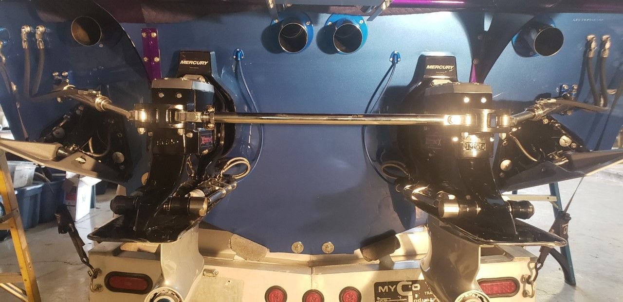

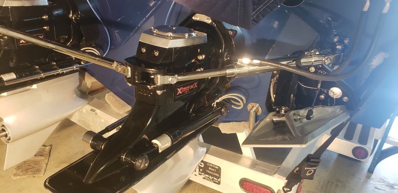

Finally everything is together and ready for a shakedown run. Here's a few shots I got after Eddie and Travis finished up setting the indicators and drives.

those nose cones are pretty close to the trailer ?
There is about 1 inch of distance between the tip of the nose cone and the trailer. When the 1/2 inch drive spacers were installed it was really close. Also my winch strap is marked so that it sit in the same position every time when loaded. The pics are kind of deceiving on how close it actually is and it's actually plenty of room there if looking in person.
