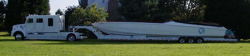

We were using an F-450 (pictured below) to pull the Top Gun and Gladiator when we were racing. A 350 would have pulled either of those boats with no problems, but with all of the miles that we were traveling, I liked having the bigger brakes and heavier suspension of the 450.
I thought that this truck would be OK for the Apache as well, until we got a total weight for the boat and trailer. The boat weighs almost 13,000 pounds and the ship weight on the trailer was just shy of 7,000 pounds. Now add all of your gear, 400 gallons of fuel in the boat and 100 gallons of fresh water in the tanks on the trailer and you have a LOAD! After putting all of this together, we knew that we had to find a larger truck. There is no doubt that the F-450 would have pulled it, but it would not have been very safe and it certainly would not have been within it's legal weight limits.
After shopping for a few months, we decided to go with a Peterbilt from Texas Trucks (pictured below). We sold the F-450 and then flew to Dallas to pick up the Pete. The Pete was a 2002 factory demo, but it only had 4,000 miles on it and it looked brand new. The new Peterbilts were quite a bit more expensive, but since this was a demo, we got into this thing for what an F-650 would have cost. I can honestly say that this Pete handles the Apache with no problems at all. It rides really well and is extremely comfortable, but the best part is that it will stop on a dime.
Keep in mind that our Apache is two feet shorter than the one that you are looking at and we don't have a cabin in the bow. Another thing to keep in mind is that the weight of these boats seem to vary quite a bit from one to the other. It seems that if you took two Apaches of the same length, one may weigh quite a bit more or less that the other. To get a weight on that particular boat, I would talk to the current and/or past owners. They should at least be able to give you a "ball park" figure.
As you know, I traveled down the same road you are heading for not too long ago, so please let me know if there is anything that I can do to help. Meanwhile, good luck and happy shopping.

Jayl13: When we bought our Apache, it still had the original Myco under it (pictured below). This trailer was a tandem axle with dual wheels and it had the hydraulic air brakes. It had the potential to be a really nice setup, but it was in bad shape and had a substantial amount of rust in a few areas.
After comparing quotes to repair that trailer with a quote for a new trailer, we opted to build a new trailer (pictured below). This time we went with a triple axle Myco with electric over hydraulic disc brakes. We chose to go with a triple axle over a tandem axle with dual wheels simply because it is easier to change a flat tire on a triple axle (compared to changing the inside tire on a dual wheel setup) and there are only six tires to replace when it comes time rather than eight (not including the spares). As for the brakes, we chose electric over hydraulic because that seems to be the most common setup. This will be helpful in the event that we ever need the boat transported anywhere.
If you purchase this boat and the trailer has hydraulic air brakes, you do have a few options. You can add the air brake setup to your F-350 or you can convert the trailer from air to electric over hydraulic brakes. I don't know the cost on either of these options, but that is what we were facing before we decided to replace the trailer mentioned above. Again, if I can help at all, please let me know.
