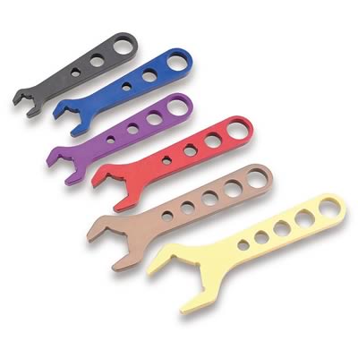

I have always used teflon tape with good results but it has pipe dope in it now. These are 3/4 NPT fittings on the inlet and exit of the sand strainers and they are leaking from both sides. I plan to pull them off and use teflon tape and see how that works before I start cutting the water pickups or trying to reduce water pressure another way.
They have those pretty blue fittings. Anyone know a good trick to wrench them without marking the finish?
http://store.summitracing.com/partde...5&autoview=sku

worst wrench's ever!!!!!!!!!!!!!!!!
i have made 100's of AN lines. my race can and the others i have built all have out fuel systems, nitrous systems, tranny lines etc etc all out of AN stuff. i just redid my hole system with the newer black stuff. i picked up those wrenches a few years bac, ive used them maybe 3 times at most. they are way worse then a basic adjustable wrench
the best, and i meen best way to mess with those fittings is to put 1 to 2 wraps of electric tape around them, then put a squeeze on them with a cresent wrench do your thing, then take the tape off.
this works best from the 100 things i have tryed.

Thank you VERY much for your reply. That exact thought had came to mind and I am real glad to hear it will work. I did not want to invest in tools that I may never use again also.

I personally would have went the tape method figuring Id never need the wrenches again. But, being Offshoreonly I figured someone would mention those wrenches as the "correct" way to do it.

Thanks much appreciated. I have seen them before but still have a problem understanding how they can work and not mark the fittings.
An adjustable wrench works great, also they make a pair of channel locks with flat jaws which work great. You may be able to pick up a rubber insert for channel locks at a plumbing supply store made specifically for plumbing fixtures with soft finishes but would work great for your application. I will see if I can find a link to the product.
