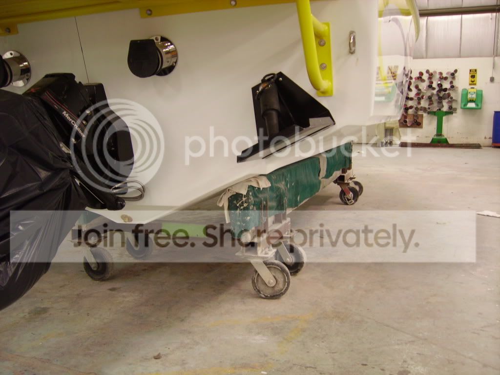

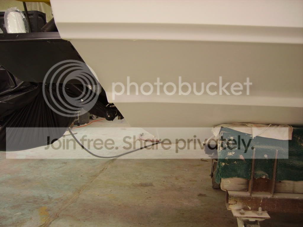

Rocko,
Trust me there is on Will's 26 Outlaw, but you say that you have the 25 Outlaw? There are 2 1/2 sets of strakes on the 26ol, but only 1 1/2 sets on your 25ol (per side)
Apples, and Oranges.....Here is the 25 Outlaw setup.
[IMG][/IMG]
[IMG][/IMG]
I hope these photos help better. Note: The shop in the background is a little more empty these days.
