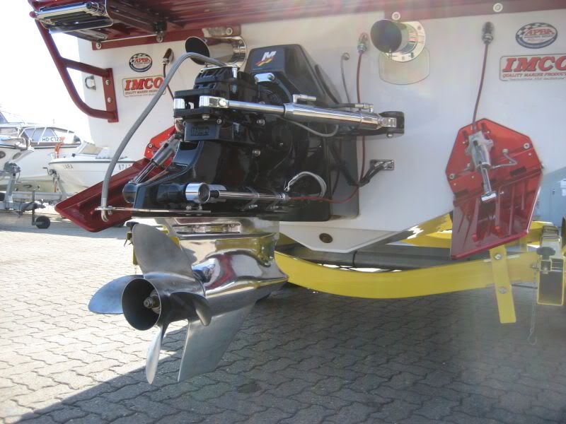

I have added a Stelling box....I am looking for a higher X and but unsure which position to start with...... All the way up or the middle position. The only thing that has me a bit worried is in the middle position the box hangs approx 1/4" below the notch. Should this have any affect on performance? I also have a 2" shorty going on at same time......where should i start? The pic below is not mine but similar. This one shows the box about 1/2" above the notch. Mine would be about 3/4" below this setup.

Wayne thats a Imco 3" raised box. Totally different than a Stellings box.

Just using it as a reference of where the bottom end of the box will sit......a visual for people.
