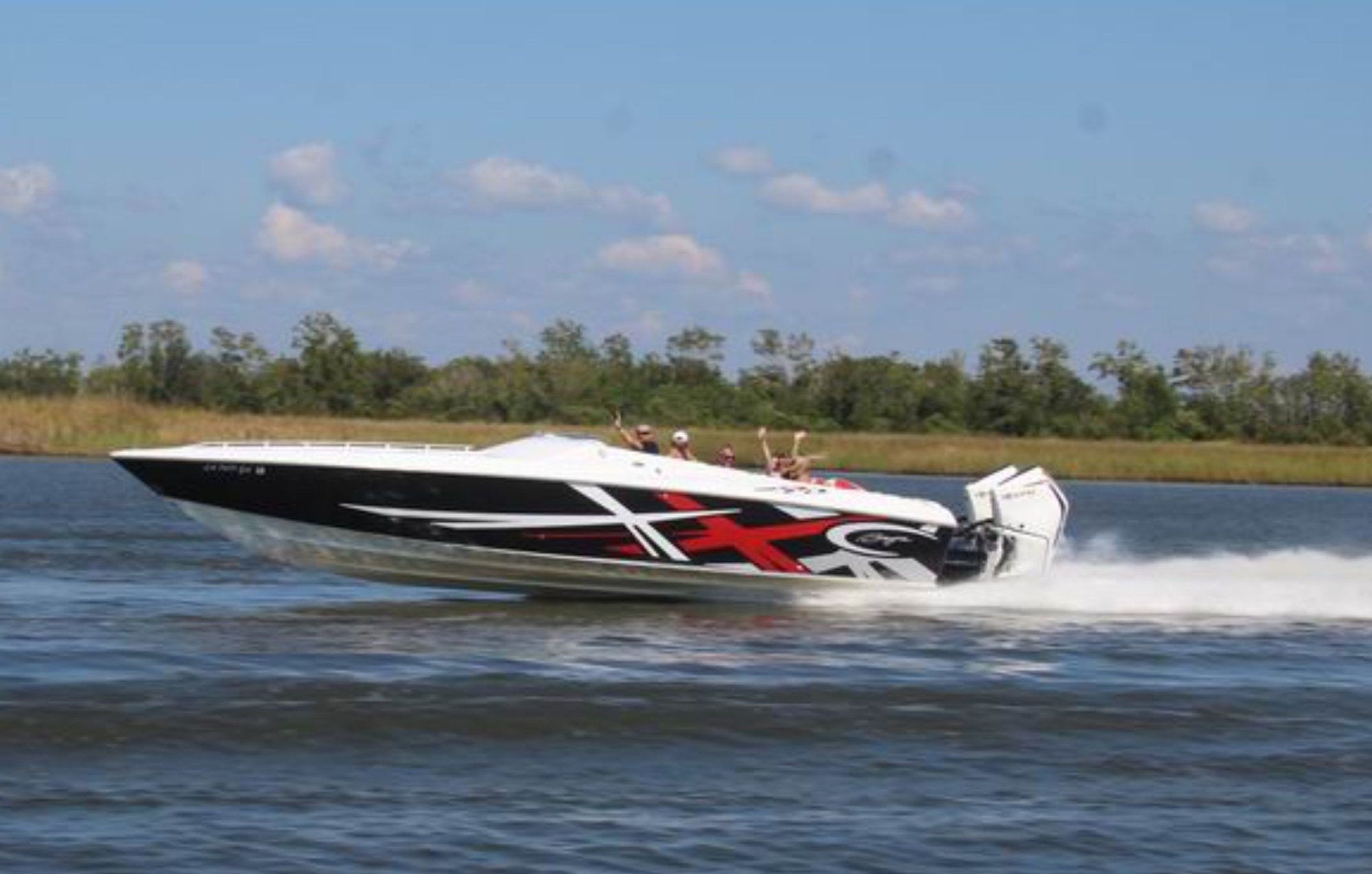

Figured I would revive this thread as I have the next Gen Baja and starting to Dial in now!
454 mags (385hp) prior and now 450rs egg beaters!
68-69 to 78.7mph so far.
34" set back with Bobs jackplate. Have 3 left of lift.
Currently running 22.5" Rev4 xps and 11-12% slip from 50mph+ @ 12% and 10-11% at WOT
Getting a lil stern lift and have to use tabs as I trim out at speed and take just a lil negative 280 tab to settle and lock down.
Hitting Rev limit in cool weather now and can barely get past 75, so 75-76 at most if im lucky.
Coming back from Fun run last month, 6ppl, light fuel, ran 77mph and usually run 75-76 easily with any load.
Spoke to Brett and ordered a set of 26p B1s to test and raise drives a little. Brett thought I was good at 4.5"- 5", I need to confirm this!
He talked me out of 5 blades and want me to test the B1 both IN and OUT along with drive height dial in best slip/rpms/speed and then figure out what labbing needed.

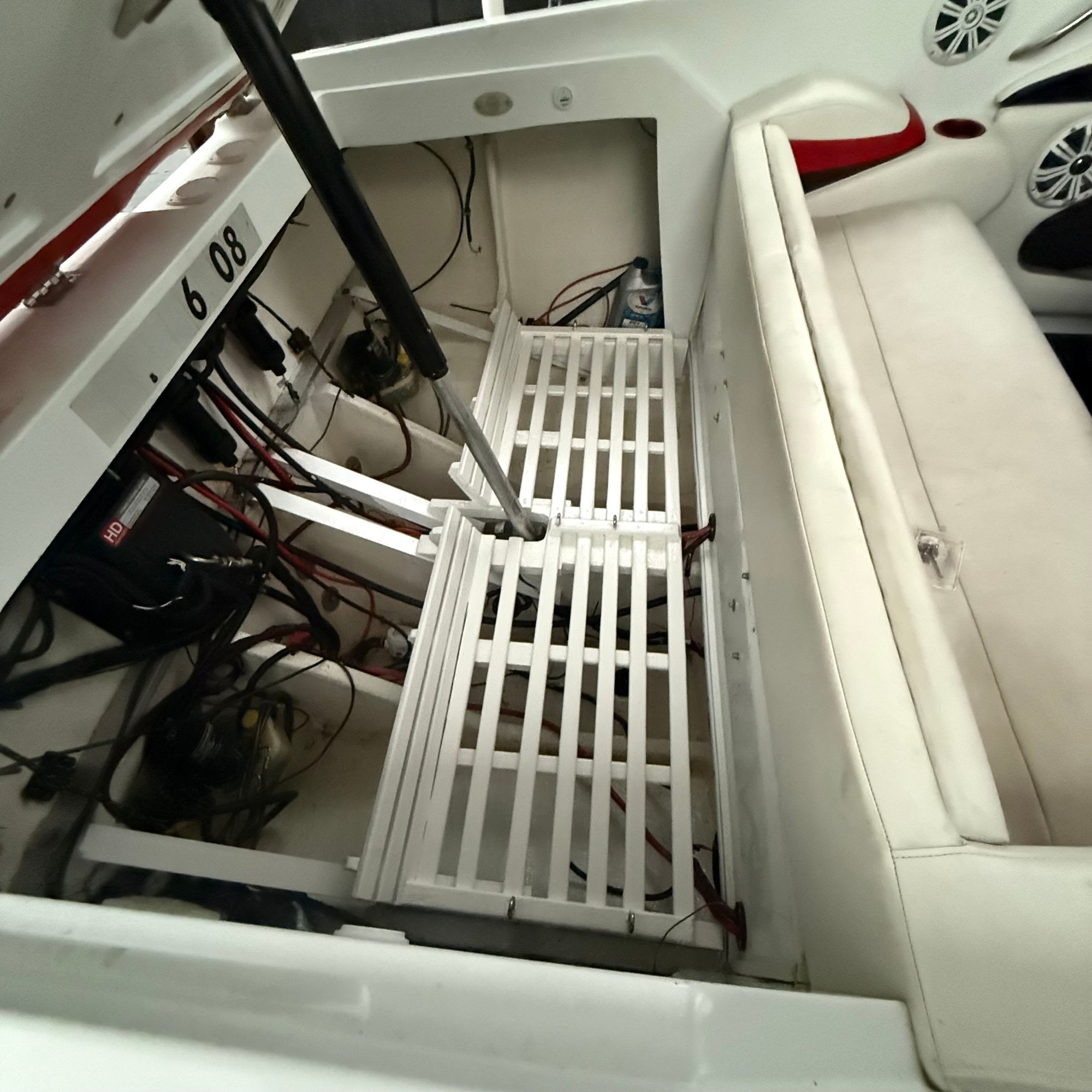

All crap is in bilge on rack built, fridge removed, 4 agm batteries under bench still.
Considering moving Batteries to stern as well.

I figure its close and have read through all of the posts, just need to account for the additional setback and drive height, but its a lot easier that I have jackplates, I can adjust as needed on the first test!
still a few questions and consensus needed:
1. IN vs OUT: speed gains vs handling at speed, I know the docking has less thrust unless you raise the drives. But mine are back more...?
2. Moving more weight to the back? I can still move the batteries, and I would gain the storage under the bench again. so 2 positives there, just dont know the gains of added weight to the back.
I'll reassess once I test the B1s.
3. Height and labbing. Based on rule of thumb, I can go up 1" or 2" from the box guys as they should be around 24" of setback between box and gimble. Im probably at 34.5 to 35" or so with the lean of the jackplate as I raise.
But other than that, figured it would be interesting.

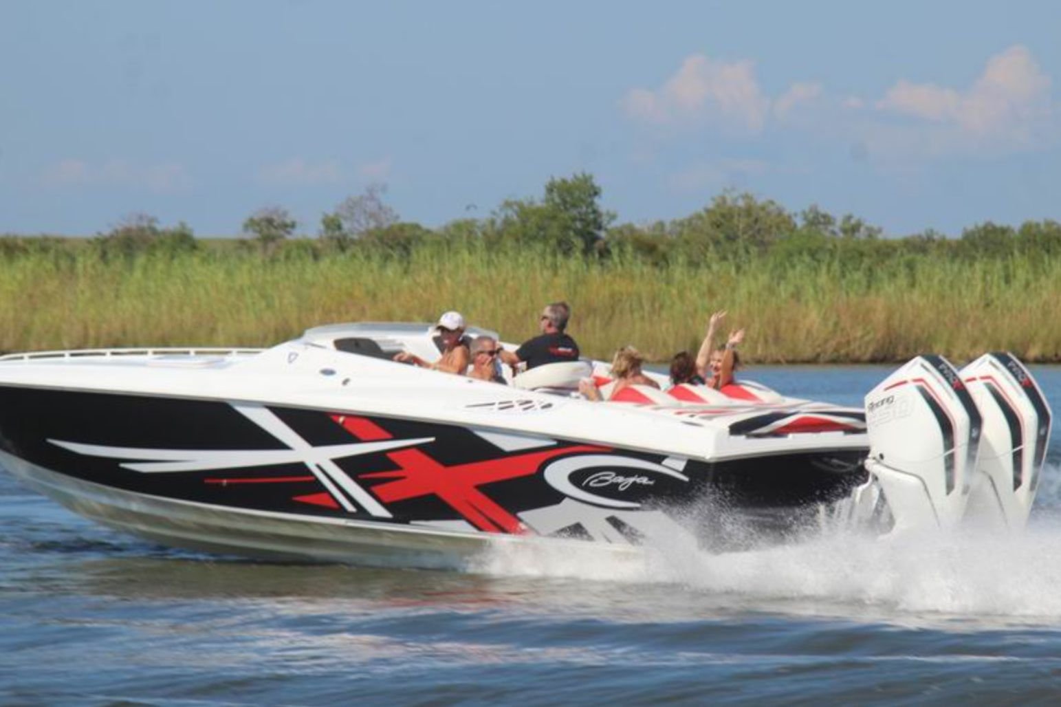

Turning in will lift the transom ...turning out more bow lift ... looks like in your pics it`s carrying the bow pretty good.

I did try to check my drive height and im currently at 4-4.5” below the hull and also my set back is actually 48” from transom to front of drives.
was only measuring the bracket and 4” jack plates, but the outboard mount actually adds some length. my bad lol
I am also getting some chine walk as I running over 65mph. Especially over 72ish, when I start trimming out, it gets loose and rocks until I add a touch of tabs.
So the B1s should let the stern settle and lift the bow. Never had this issue no matter how much I trimmed over 65 before with the stern drive and same style props, but now I running faster and higher X.

Something else you may want to test, since you have that huge storage area in the back is to throw some sand tubes on that shelf you built, that would determine if moving batteries and such will help
