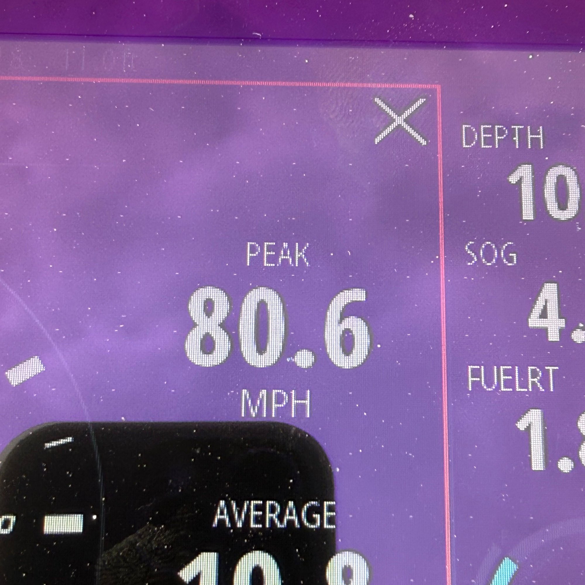

Ok… this took a while, apparently Bblades closes for several weeks around xmas to new years.
26p B1 Labbed, Brett said he labbed with 27p recipe with cup and had to match all blades and cut 1/2” off the diffuser’s.
Blueprinted the hull and sharpened edges and ended up removing the 3/16” of hook in the last 12” of hull and smoothed 7-8’ forward.
The hook removed is definitely noticable at slower speeds below 40, though trimming engines or tab down slightly controlled it.
Need some more testing for sure, but touched 80 mph with 1.5-2ft sea’s.
Previous best was 78 and ran 77 with light fuel and 6ppl on board. Low fuel and weight in the stern seemed to run faster, but could easily get to 75-76 in flat water with 6ppl and over 1/2 fuel.
