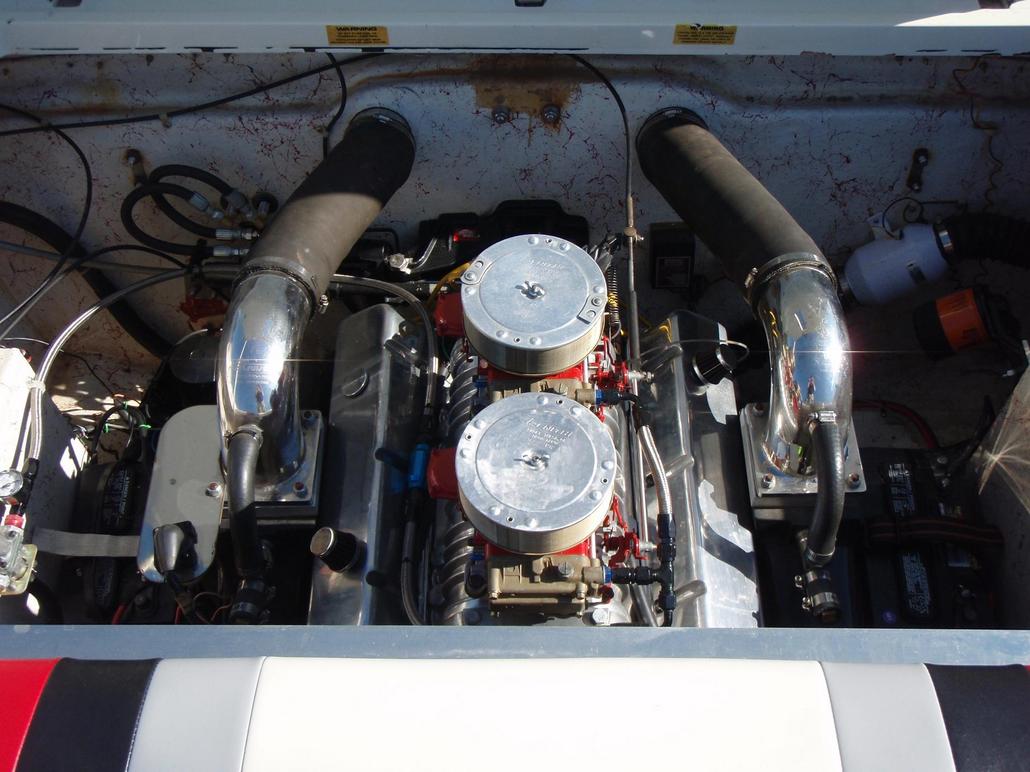

ive also ran the bravo with and without a nose cone, nose cones creat alot of mid slip!! i am running a 25 mirage 3 blade right now (until i get an xr or xr upper) i get a ton of mid slip if im not real easy on the sticks, that is with the nose cone, without it, it is not bad....
