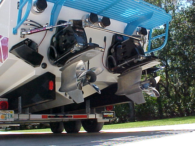

Yes, 2-3 Mph. Must be the bigger gears, and all of the oil they turn in. I tried 1.7" shorter, 1" shorter, and the X that the TRS was. I went back with the Same TRS X deminsion. The Midrange cruise is better with the longer drive by 4 MPH. I use mine at Cruise (55 MPH) for long distances. 150-300 mile runs.
To swap rotation on a transmission boat just swap the drives from side to side. A bravo boat is easier, just swap the props and put the shifters in reverse to go forward. Becareful when returning to the dock.
Attached Thumbnails props in or out??-gun.jpg   props in or out??-dsc00278.jpg   props in or out??-dsc00267.jpg

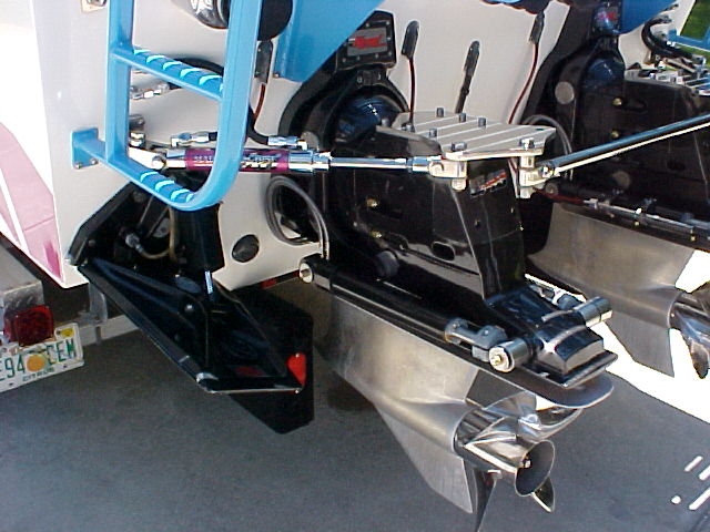

The Konrads have 110 hours and have been perfect. The lowers in the picture are the welded ones Konrad produced first. No bondo or filler.
Attached Thumbnails props in or out??-mvc-055f.jpg   props in or out??-mvc-058f.jpg
