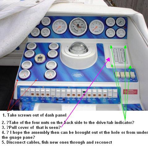

Just read through this thread and others that I searched. I am in the processs of replacing both indicater cables. How does the plastic faceplate come off? Is it held on by the four fasteners underneath located at the four corners? Since there is no way to get behind the dash of a straight bottom gun, Will the assembly come out of the hole that the trim/drive faceplate covers....? OR Will I have to bring it out from under the mane dash panel that wraps around the compus..?
Any ideas......... Suggestions..........
Thanks
Jr.

The back portion is smaller than the front so if they cut it right you should be able to pull it up through the hole after removing the faceplate.

[QUOTE=insptech;2130819]The back portion is smaller than the front so if they cut it right you should be able to pull it up through the hole after removing the faceplate.[/QUOTE
......................... Then disconect old and replace with new?

Yeah, they are held by a bracket and the heads screw on the cable ends, it is pretty self explanitory when you get in there, watch for the springs in the pointers and the spacers on the bolts and you should be fine.

put a stick pin through them and use that to hold the top and spring in place, then when it is back together pull the pin out, in the diagram it's called an alignment wire. I just did mine on my tiger.
