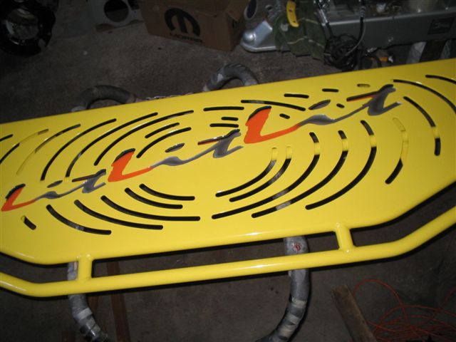

Like Dan said, I swapped mine out from the square older style to the newer rounder style.
Pulled the old one off, had the transom holes filled. I think it was 600 bucks to fill the transom & looks PERFECT.
You need to measure where the new brackets will be for the newer swim step. They are shorter and do not come down on the sides. I had to have mine mounted up a bit higher because the inside gimbals sit so high (even after I measured).
Then we had the step color matched and CNC'd with the boats name on it.
Here's some pics of the old and the new.
Phil is a good resource and his product is VERY nice (Hope I don't get flamed for saying that). But you (being in Italy) will definately have to make sure your measurements are correct.
