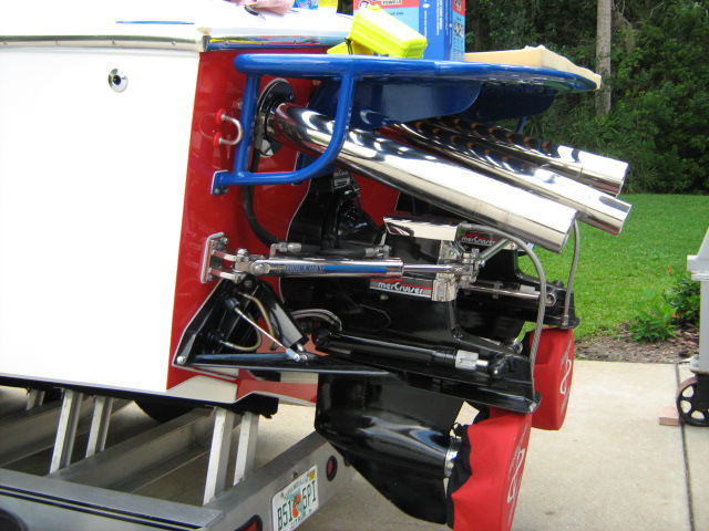

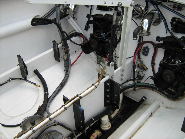

Can't remember if 90' was a straight or notch......here are a couple pics of a straight bottom with Bravos in the TRS location like I think you are talking about doing.

Its a notch transom and yes that is where Im heading with it..... The standard lengh Bravo's are 2" shorter than the TRS drives and Im wondering how much higher(if any) I can cut out for the Bravo set-up or just cut out as the same location as the TRS. The search goes on my man but I will figure it out
