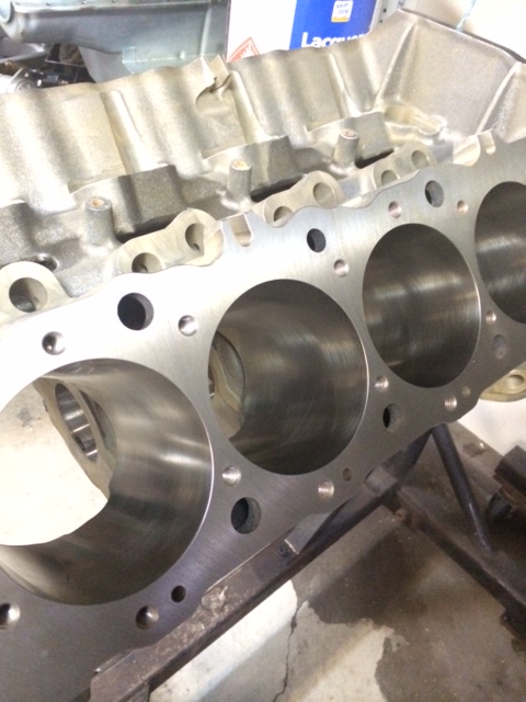

Looks like the block is fresh from the machine shop. Whats the RA finish on that deck?
80 grit flap wheel

What shop? deck was scotchbrite wheeled... I cannot believe what I see....
this is what a freshly decked block looks like, nice and perfect... square decked pistons to be .010 in the hole...

He has no idea what "RA" is or why it's important.
