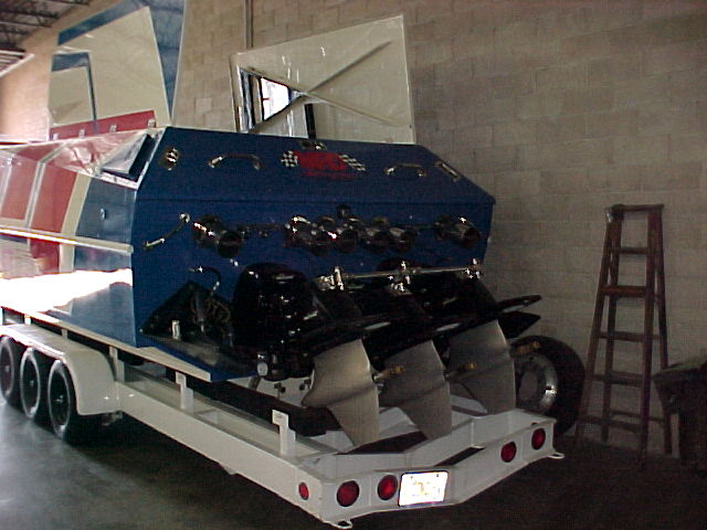

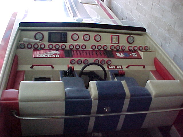

Originally Posted by Zero Patience
Yes, went with 1.61 gears, so the prop turns
Slower, so more pitch is needed to get back where it was. The main thing needed is diameter. Everyone says mount the drives 3 or 4 inches up, a old cig is not an airboat. The prop needs to touch the water, this one is 1" above the bottom, and needs diameter to get a bite. The staggered setup limits diameter to 17.5 " , we tried sliding on my 17.75" but they were to close to run. (In my opinion, there my new props) Merc Racing is building a new set as of today. Did not choose 1.61s that is what came in the drives, it was decided to spend money on props early on, instead of gears.
Thanks for asking. Good question.
There's a set of year old Hering 17x 32 x 18r 5 blades for sale at a great price.
Post a pic of the Cougar.
MP will love the Mid range acceleration with that gear also
90% of your boating is spent in Mid/cruise range anyways.
What is your hopefull Final Dia. & Pitch?
Here is a pic of my Trailer Queen ya asked for, bought it as just a Hull
and It's about 90% complete
Jon
