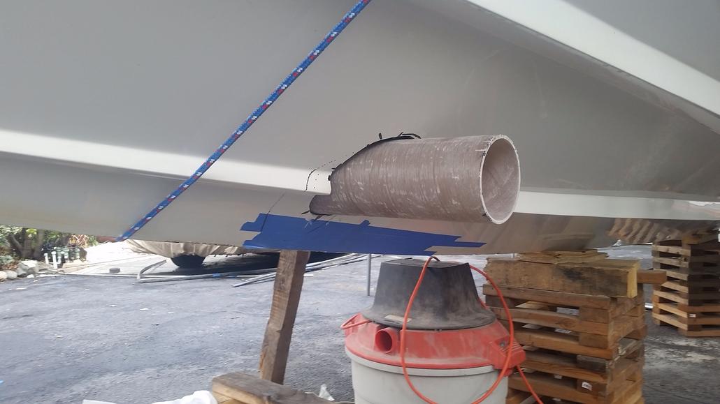

Just a quick update. I was delayed a little on project...lost my space where boat was worked on. Had it moved to my house. Now I have to finish quickly, it's tying up part of my driveway! Picture attached is bow thruster tube being fitted. I'll send more pics when there's more progress. I would like to be finished for this summer!

Hi i have a 41 in the uk. thinking of fitting a bow thruster ? can you tel me witch modal and tube side you have on yours thanks Ricky [ATTACH=CONFIG]549507[/ATTACH][ATTACH=CONFIG]549507[/ATTACH]

I am using a Lewmar 140TT model with 5" tube. When you read specs it's going to say for a smaller boat...our boats are not like cabin cruisers with a lot of surface area exposed to wind, so this unit is totally fine. My purpose of adding is aiding in a docking situation. Your best place to locate is under your water tank. Honestly, when I removed the original aluminum water tank I found surface corrosion that would have required a new poly tank soon anyway. Once you have the tank and tank flooring out of the way, you will be surprised how much additional space is down there. Hope this helps!
