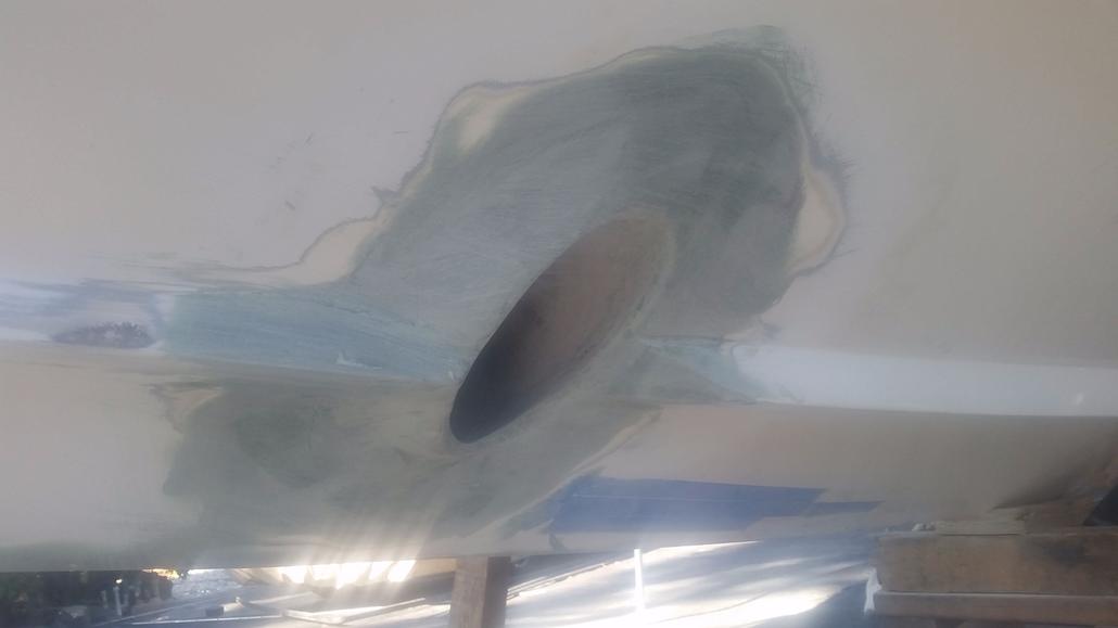

Originally Posted by Cig41
Just a quick update. I was delayed a little on project...lost my space where boat was worked on. Had it moved to my house. Now I have to finish quickly, it's tying up part of my driveway! Picture attached is bow thruster tube being fitted. I'll send more pics when there's more progress. I would like to be finished for this summer!
Was going through the chine the only option? That just looks iffy to me.

We went through a long thought process before proceeding. The bow sits very high when sitting still or idling, where the tube is located, there's only 5" from top of tube to surface, and the tube is above bottom of V the suggested 4" minimum. While at planing speeds, the tube is no where near the water...in rough seas, if the tube area impacts the water, the leading edge of opening has been flared out to direct water away from opening, and the strake to back of opening has been flared in.
Should be just fine!

Here's a shot of the bow thruster, port side, with fiberglass work complete. Just needs gel coat. I'm still shooting to have boat complete for some summer fun! Lots and lots of prep work!
Helps to attach photo!
