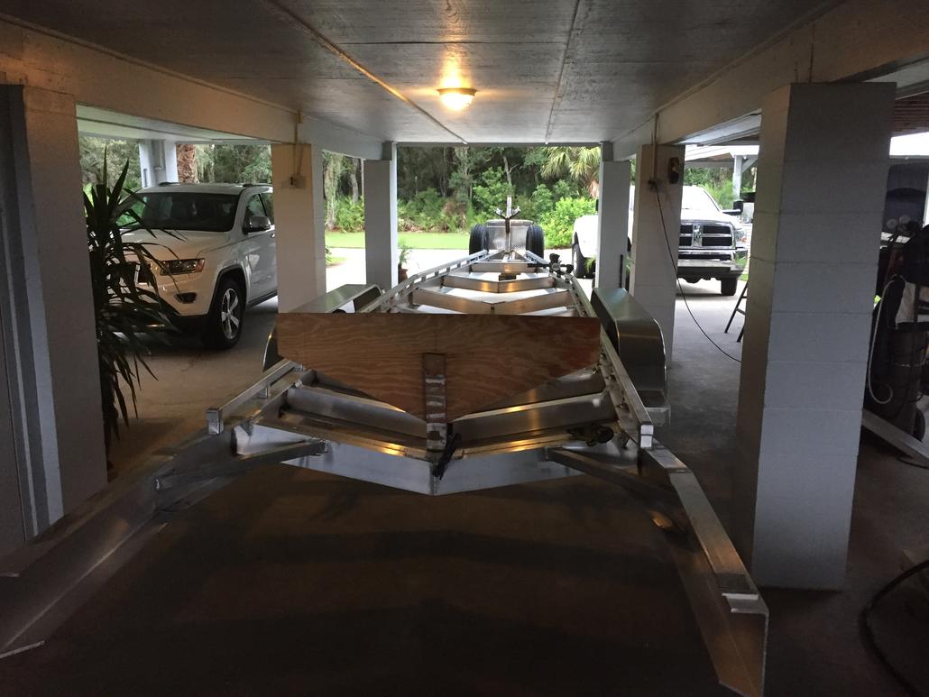

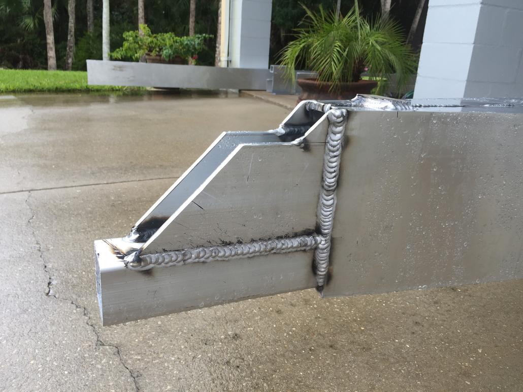

Thanks for the compliments, it was a lot of work, about 100 hours. I had the axles when this came to be. I was planning to replace the axles on the old trailer, otherwise there would have been a wait for the axle order.
The tongue pic is from when it was upside down. I had the cig bottom jig from the build 9 years ago.

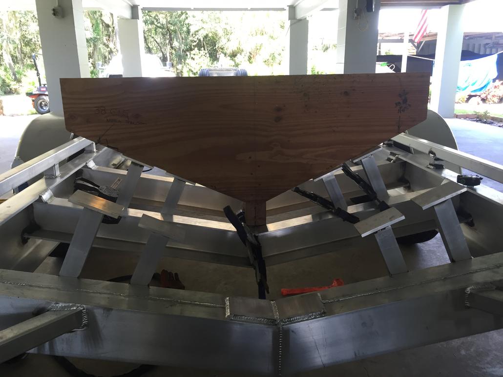

I used 3/8 plate for the bunk mounts, the stuff in the new EPA approved PT lumber, when mixed with salt water will dissolve aluminum. I did not use PT lumber for the bunks.

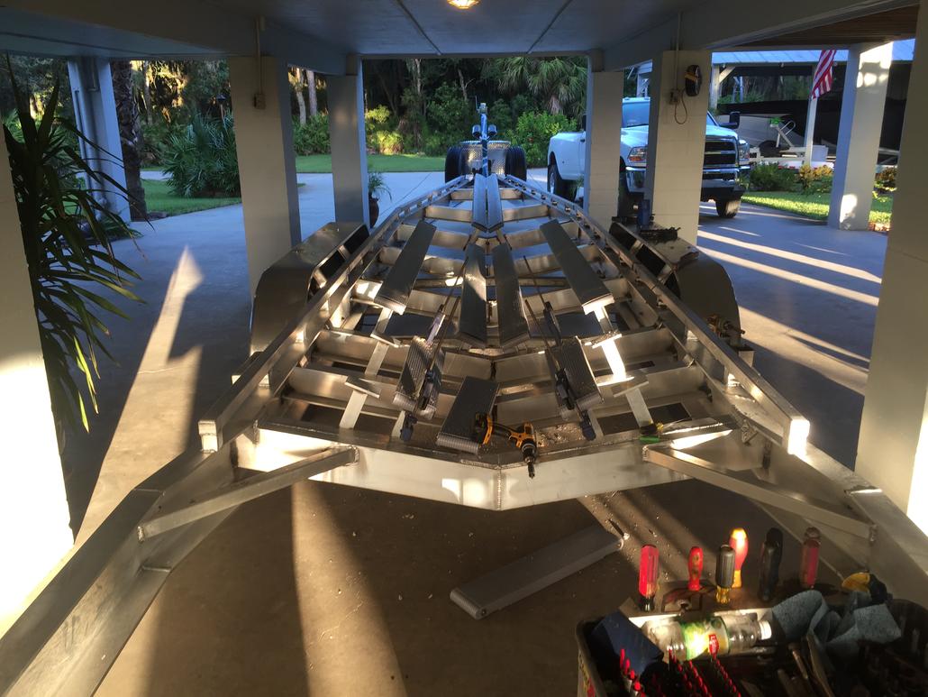

The last half of a gun is easy, the bow section is not, it is a compound curve. Takes a lot more time.
