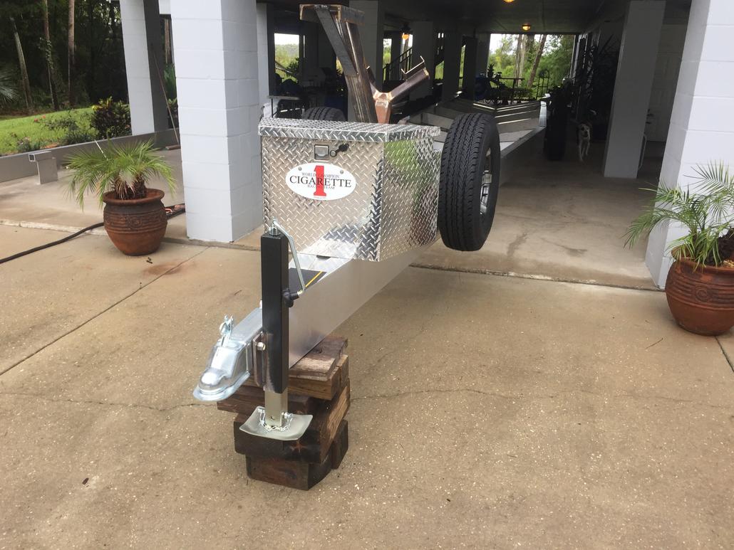

The trailer under my Gun that I built, had its 9th birthday. So when the opportunity to sell it popped up, I let it go. Someone is going to get a nice trailer. Here is the metal for the new one strapped to the old one.

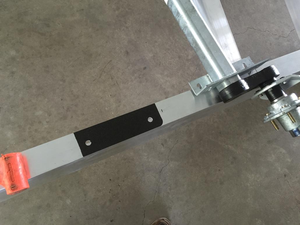

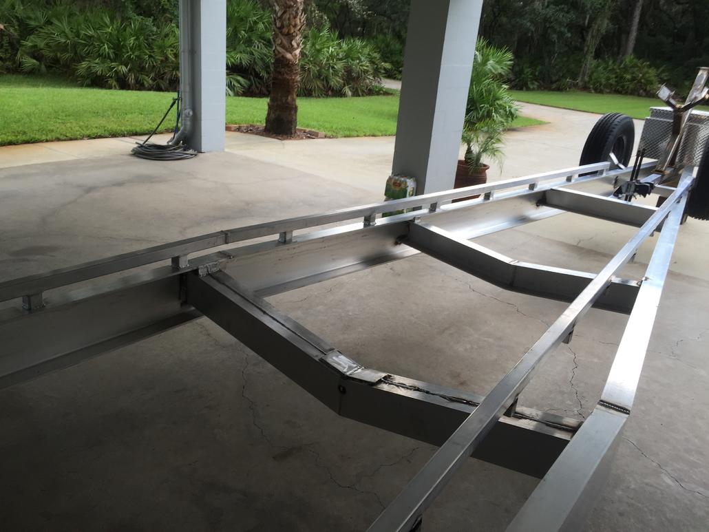

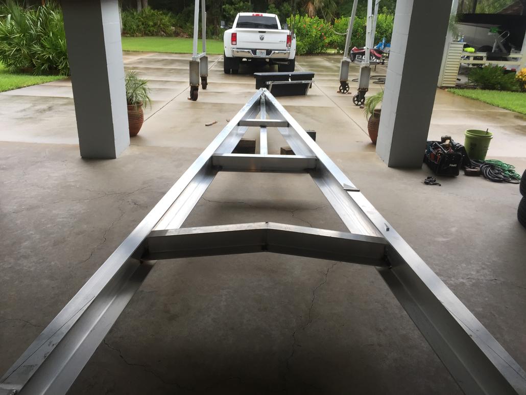

I made the new one the same size as the old, but used one piece channel on the side rails that incorporated the drive guard

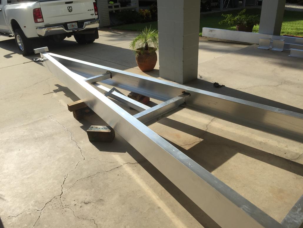

I was not bored, but a trailer was needed for a Lanier top gun, and mine got the call. I had two weeks to build it.

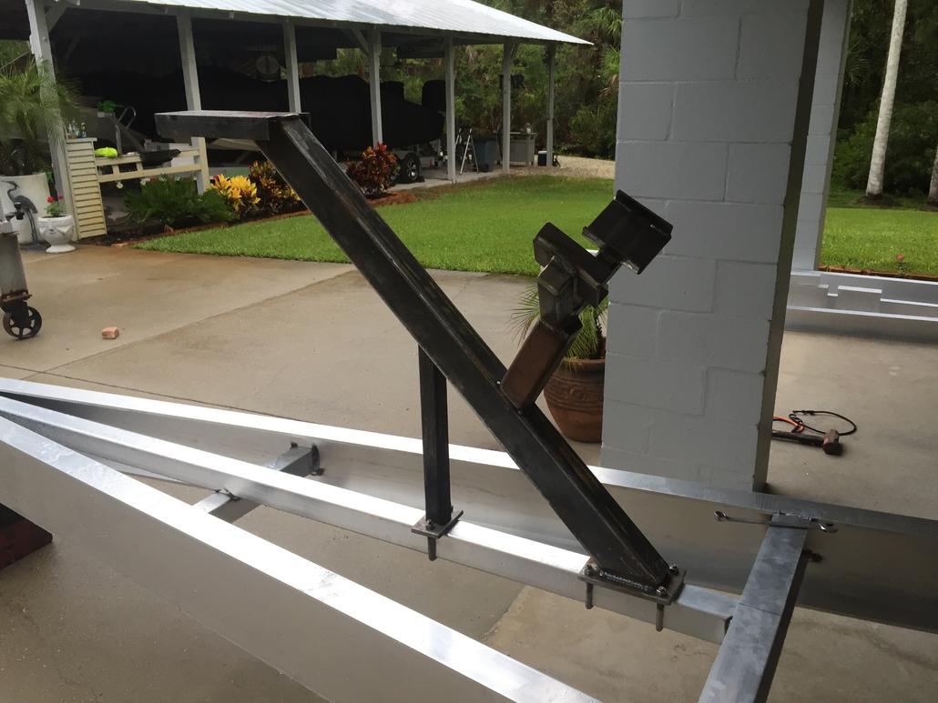

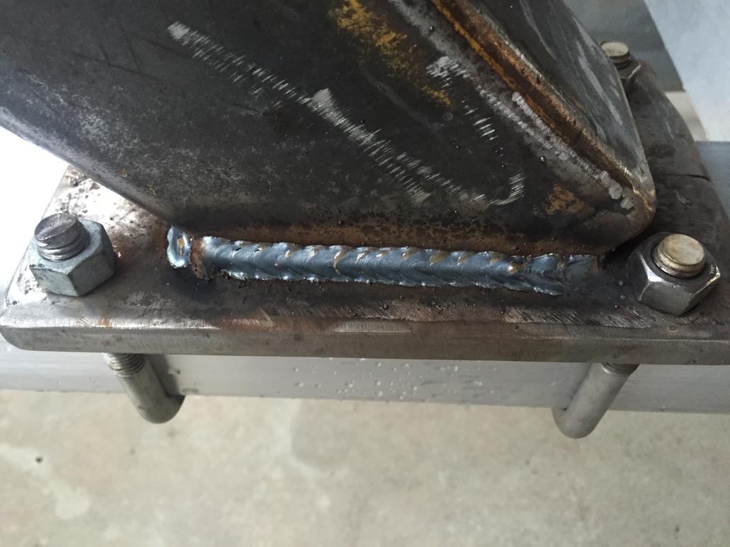

It rained for about 4 days straight, so that helped keep me on task. The winch stand is always steel, there is some of my soldering...

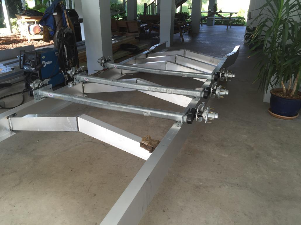

I ordered the same wheels as on the old trailer, used Goodyear wrangler ht tires on them, 8 total. Installed Air -tite hub seals on the 3 axles.

Dexter axles? And did they come with, or did you swap to Timken bearings?

Used a miller 252, with a 30A spool gun, 4043 wire. Al metal is 6061 T6. 16 rolls of wire in it. I made the fender mounts out of .125 plate, cut and welded to form them

Rockwell American axles, 0 degree, 6k, galvanized, used slip on Kodak disks, on all axles with a Brakerite pump. Some people pay to go to the gym, I turn the tongue jack.
