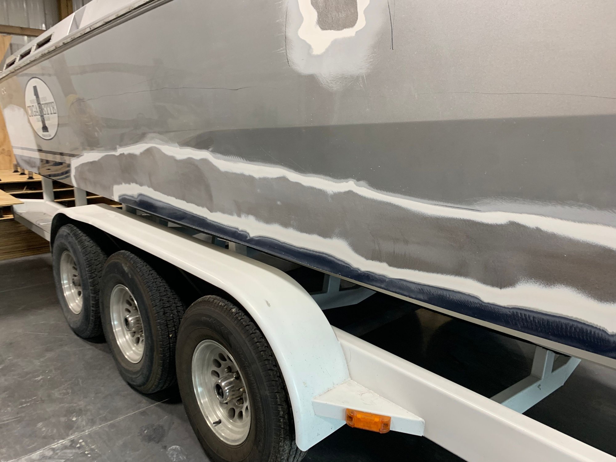

Got done grinding done
Going to do some spider crack repair!!

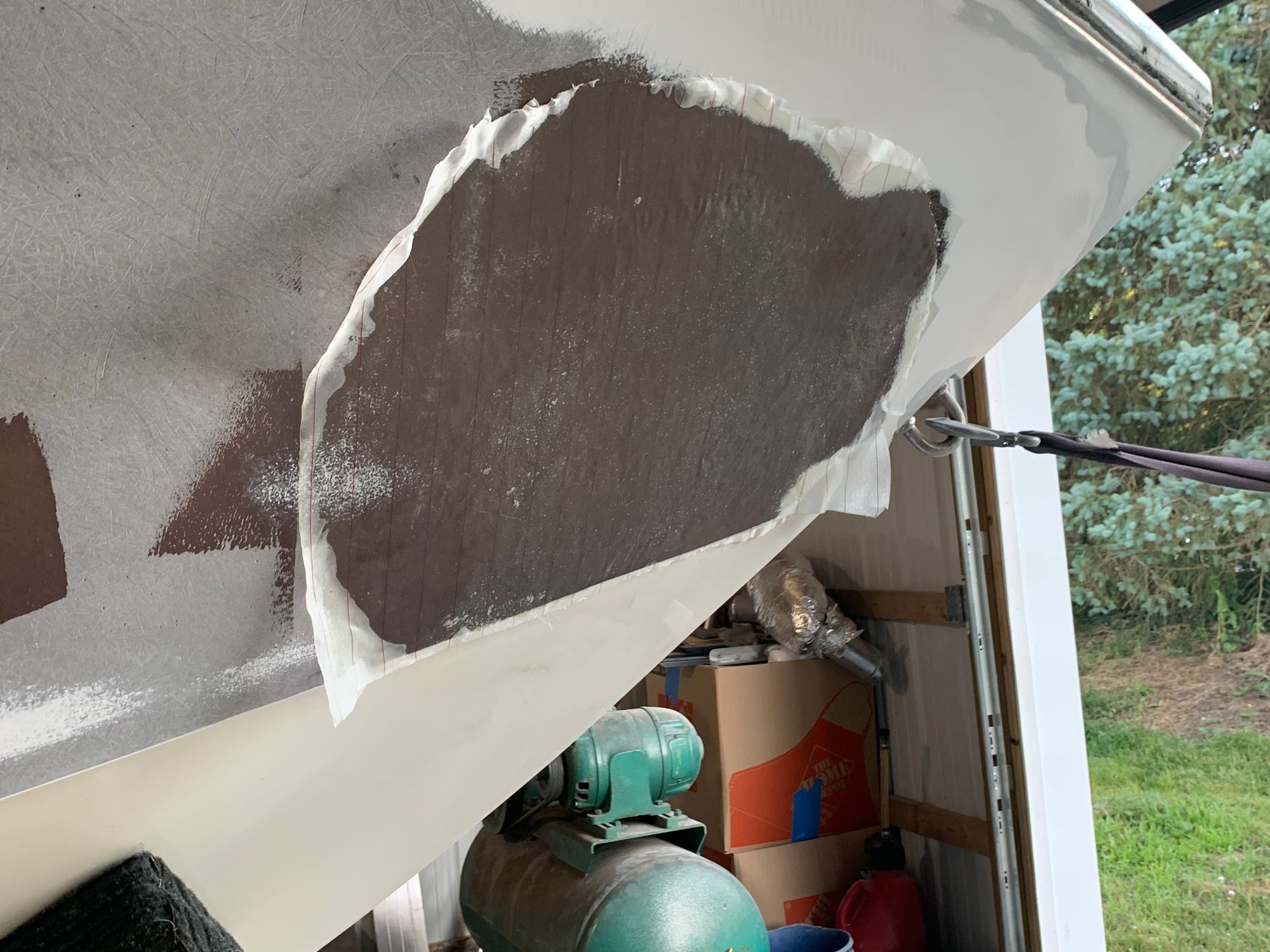

After we ground it all down to the glass got all the old gel off we sanded it with 36 until all the small stress was gone. Them put a new layer of mat on the area with some peal ply to make it smooth (thanks glass Dave) going to spray new gel coat this week and then on to sanding!!! Luckily the small stress was only in the outer glass!!!

If you look close you can the cracks before we started 90 percent were just in the gel

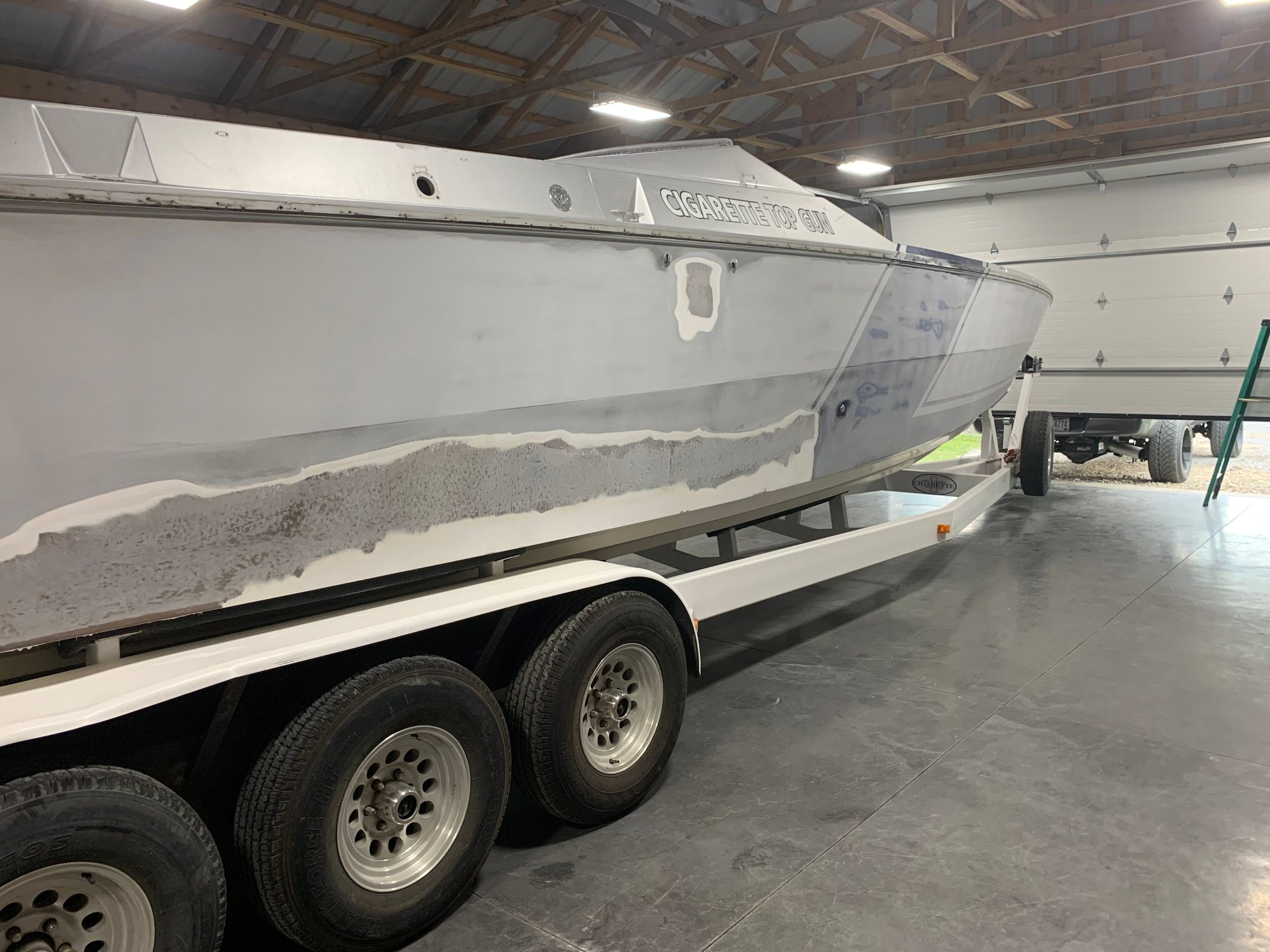

Got the hole side sanded today with 80 on the big sander all the glass work is ready for new gel. Hopefully this weekend!!! Then just a good blocksanding and on to the next side.!!!!!!
