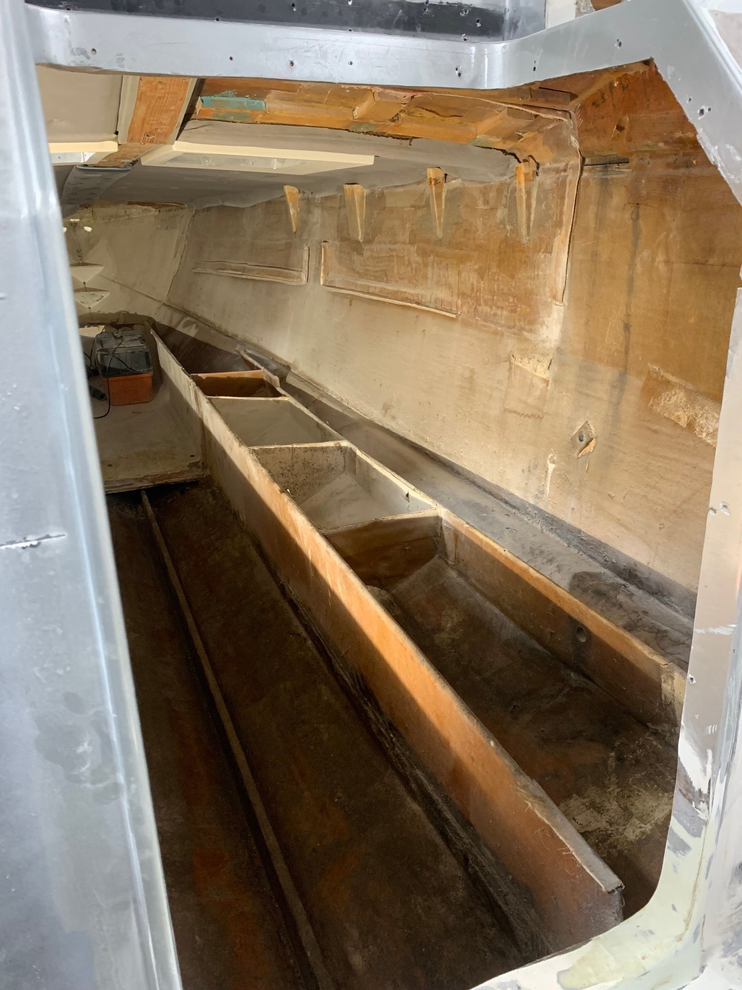

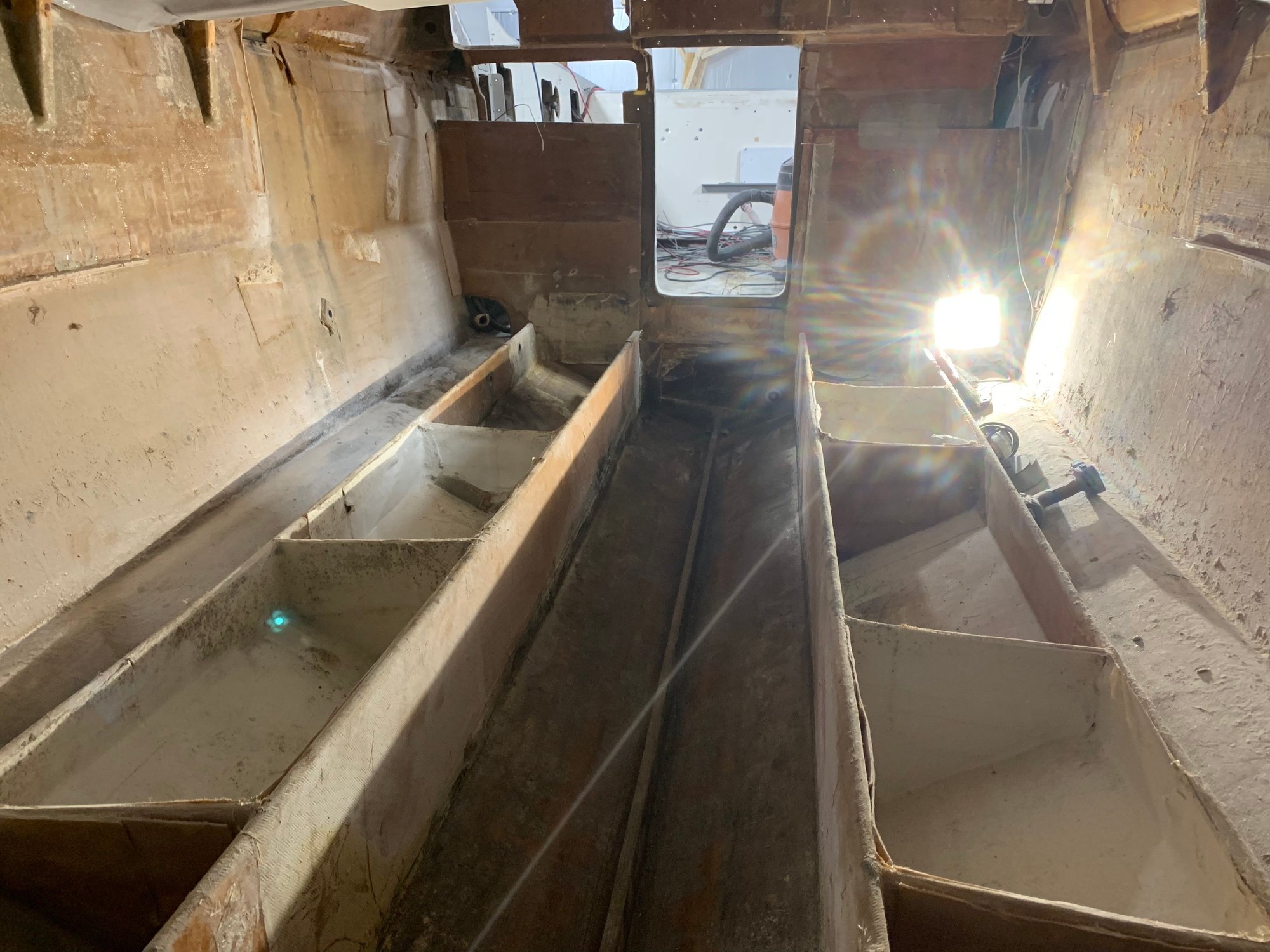

Liner out
Bulk head time
Swim platform legs done on to the top section

Yep lol all good tho making real good progress. We’re going to spend about 8 hours in there Saturday sanding and grinding. Hopefully next week start putting in bulk heads and gel coating down there.

Only had a bout 2 hours today before I had to be at work at 7am lol but I got most of the interior boards that were glass on to side and top cut off almost ready to suit up and spend 20 hours grinding entire cabin springs coming fast !!!!

Thanks for the pics that’s exactly what I’m thinking. Just happy to have that liner gone. I’ve been working on it every available hour lol. Anyone know best place to get tanks from? I thought I had a place turns out there a super long wait. Anyone thoughts on moving port Moter forward 12 inches. That cabin is going to be very light. I am going to shorten the fuel tanks and put them all the way up to that step bulk head. That will take 30 inches from the rear off.
