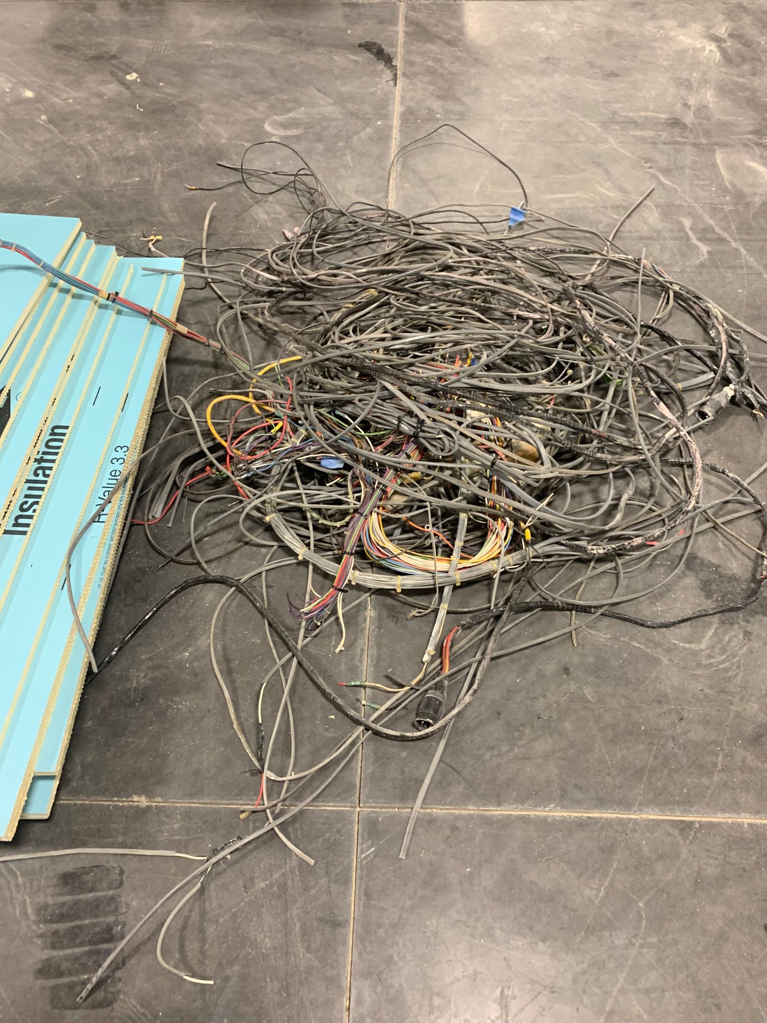

Yes I’m defiantly something simple I’m going to put 2 couches back in and a small bed up front light weight and simple. I really didn’t plan on rewiring entire boat but it kind of just snowballed into that after I started cutting cabin wiring out ended up just cutting all of it out. I do think it will be easier to start from scratch instead of trying to patch up old stuff

Well it’s officially a bare hull all cabin and every wire from the boat is out time to start grinding and putting bulkheads back in down there
division1 is offline
