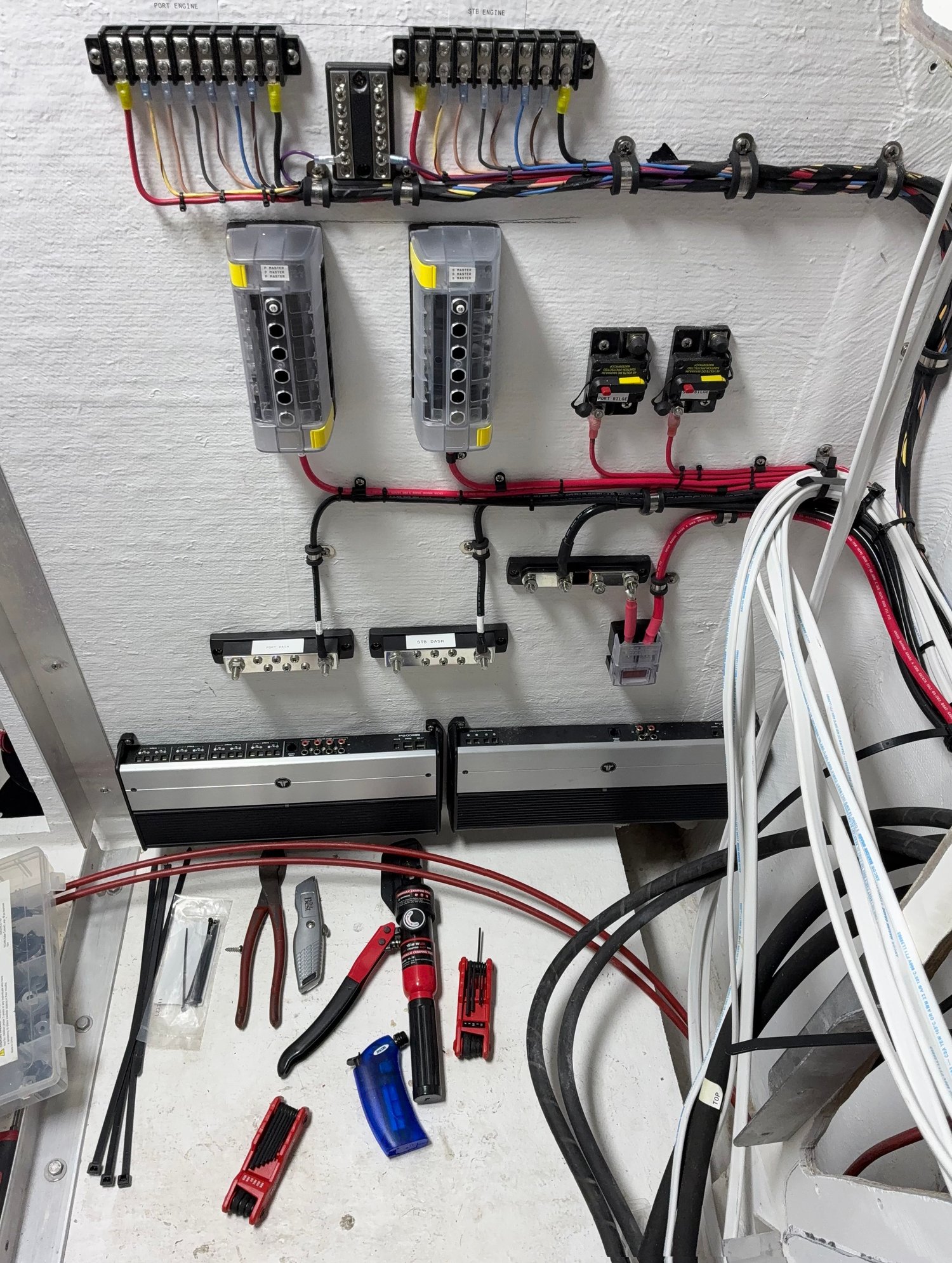

Update .bilge is rigged with all the small stuff trim pumps , bilge pumps , all new trim lines , harnesses ect. I did all that ran all the new trim lines and was able to do a system test on all of it before putting engines in to test for leaks and such. Ran all new steering lines ,engine harness. I ran all the new power and battery cables and labeled it all been a real process lol. Getting there

Starting to assemble helm wiring
https://cimg7.ibsrv.net/gimg/www.off...19e6adb77.jpeg
This my not look like a lot but I can tell you it took about 15 hours and I’m only 1/4 way done lol

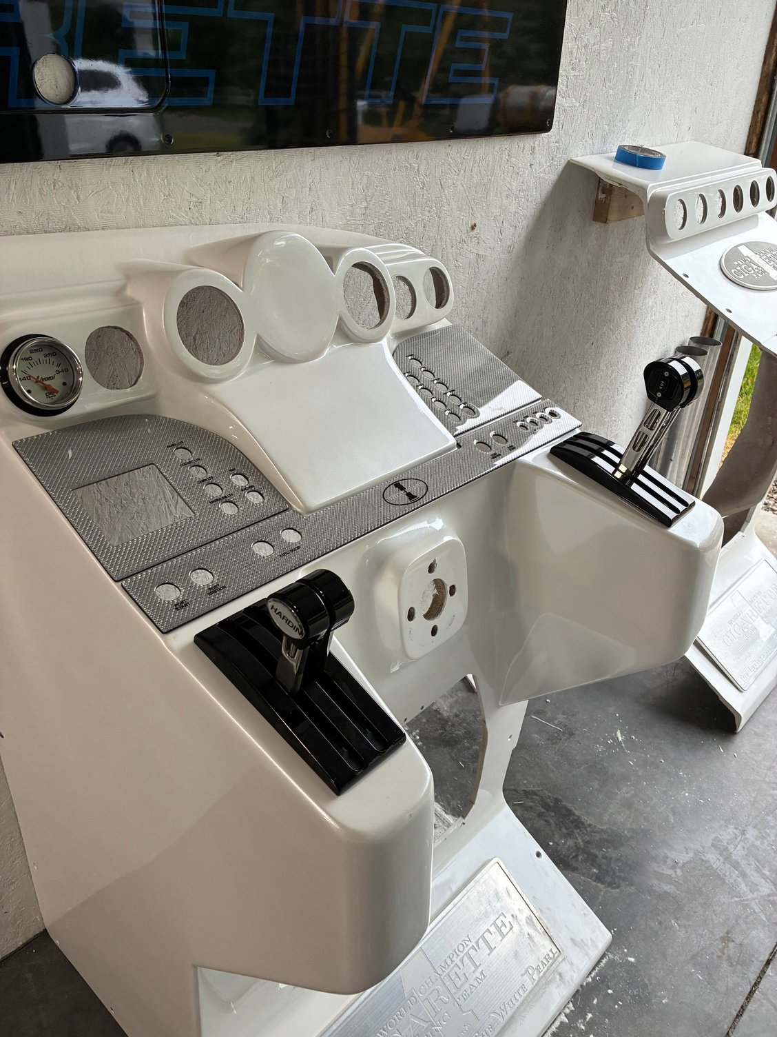

https://cimg9.ibsrv.net/gimg/www.off...363fb0c8e.jpeg
Fitment of gauges and plates. With all new throttles and shifters

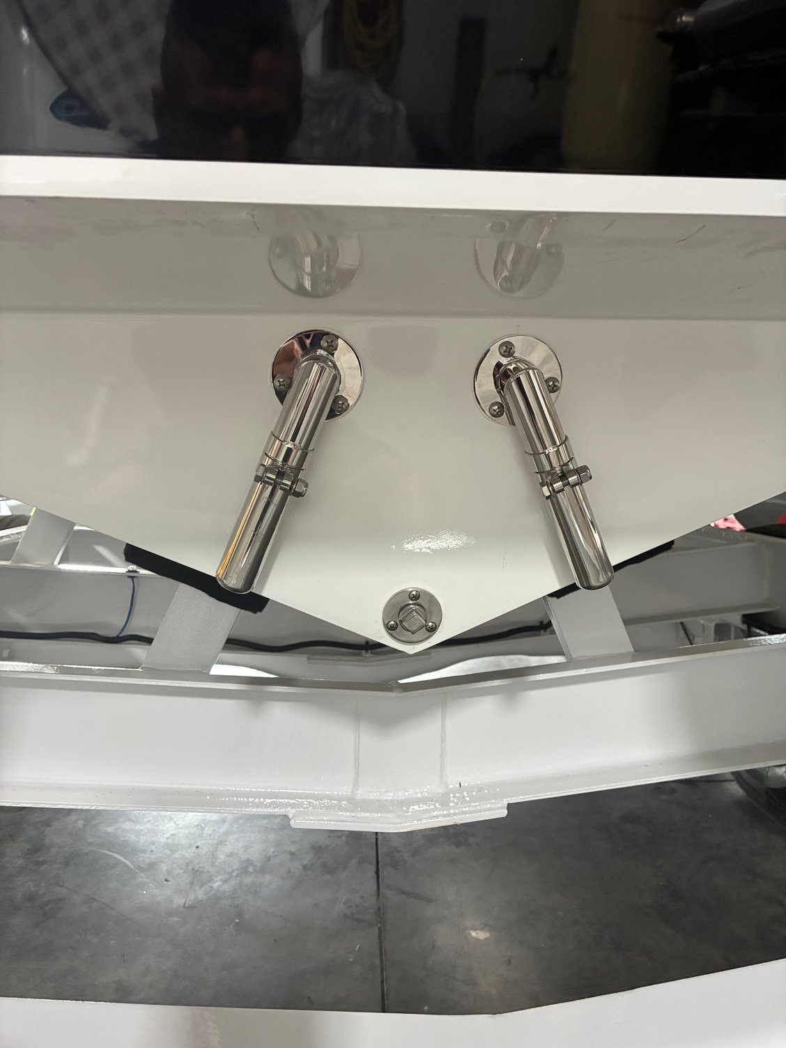

Water pick ups installed

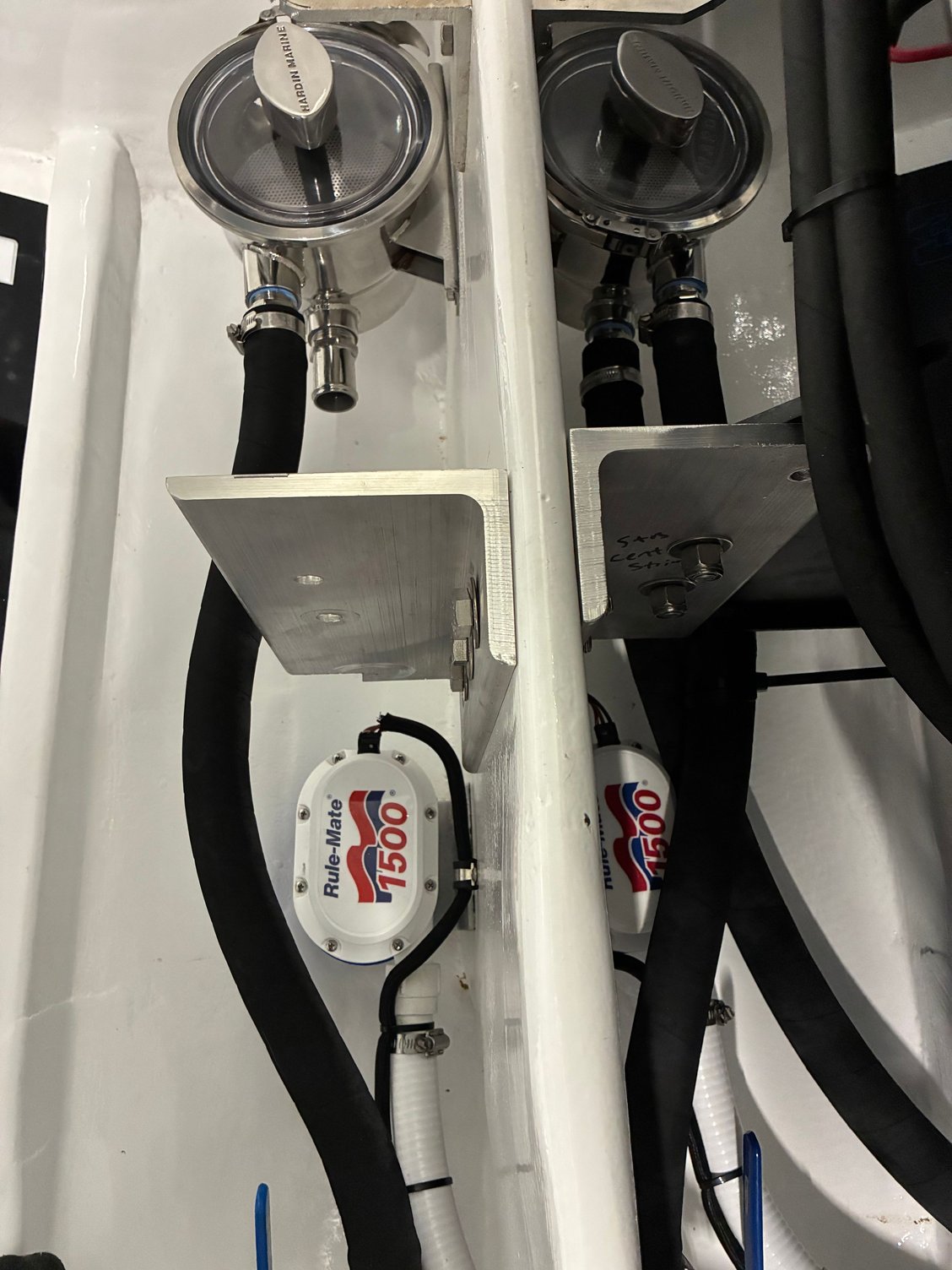

Strainers and plumbing

Very nice, if pickups are an issue later look at how this guy did his

green lightning 06-06-2025 08:03 AM
If those water pick-ups are Hardin Marine adjustable ones, make sure the adjustable part does not move , I lost them and ended up welding them together .
division1 06-06-2025 08:23 AM
Thanks I was thinking of rig welding them once I knew I had pressures correct .
green lightning 06-06-2025 08:44 AM
My first ones only lasted for a few miles before one of my engines started to get hot and I then realized one adjustable part was gone and the other one was just about to come off .
