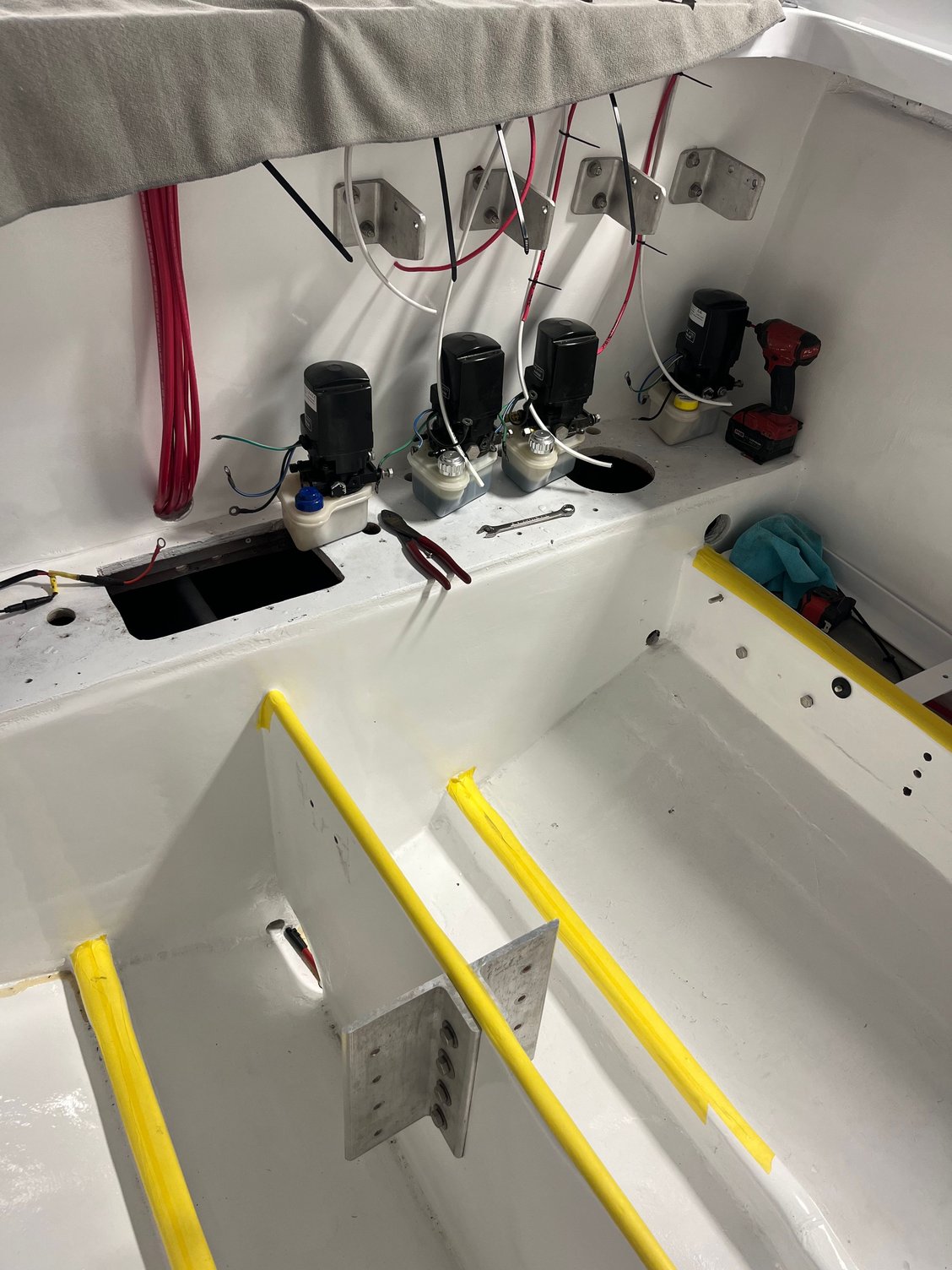

It’s definitely a lot. But I I think it’s a lot easier starting from scratch. I have a some wiring schematics sent to me by a oso member so I’m just taking my time and getting it done. Hashtag long project lol

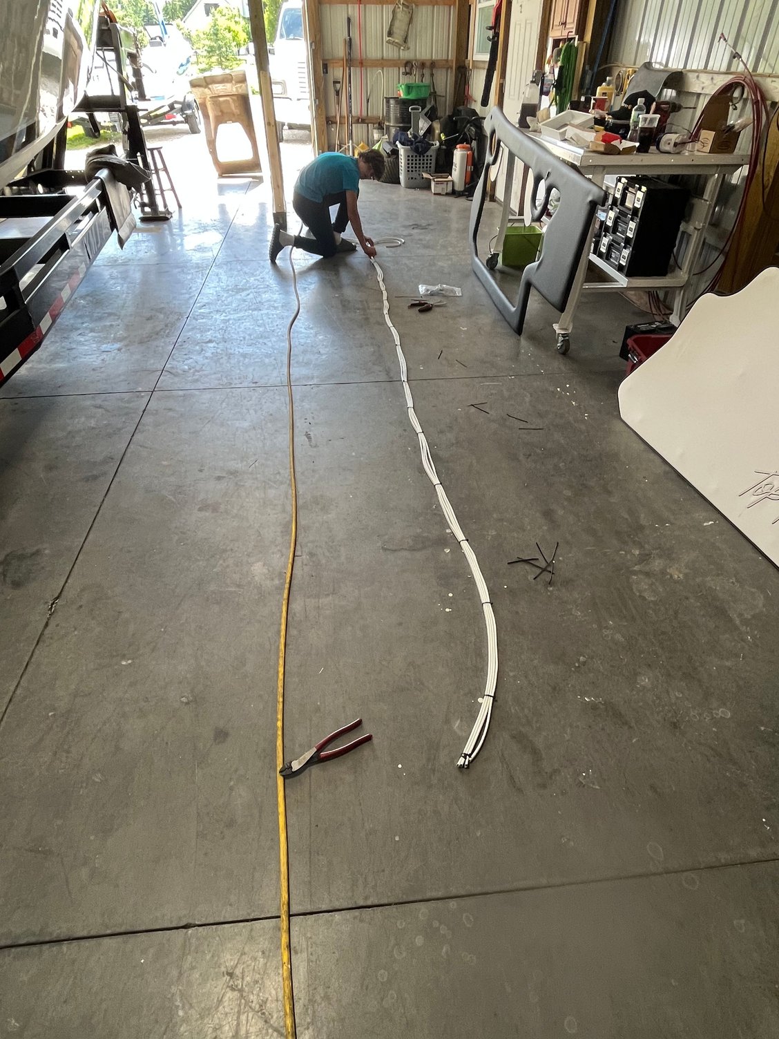

division1 06-16-2024 09:34 PM
https://cimg0.ibsrv.net/gimg/www.off...4574b1809.jpeg
Getting ready to mount some things

https://cimg3.ibsrv.net/gimg/www.off...3a209828d.jpeg
New steering hose lengths figured out
