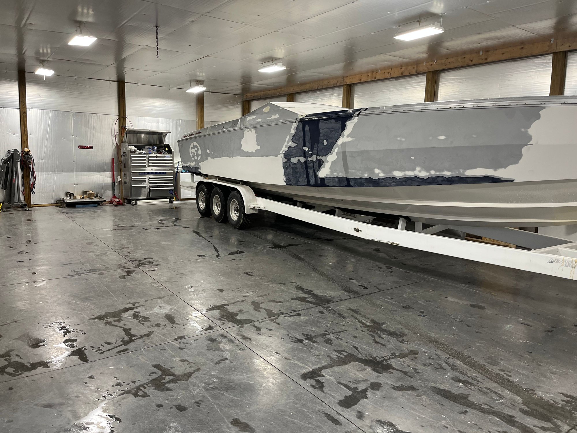

All done with glass work !!!!!!
Cleaned and moped !
Glassed in bulk head
New floor is 3/4 marine ply with 4 layers of 1708 on top and 2 on bottom!! No flex here !!!

Time to start fitting pieces !!!

I have a new floor section made to put in we’re the old one is for know just not going to drop it in till I’m done fitting done want to ruin it. It’s all cut and glassed with gel. I used a non skid came out nice it meets right up to the new permanent front piece

Talking
That`s going to make it hard to get in the cuddy .
